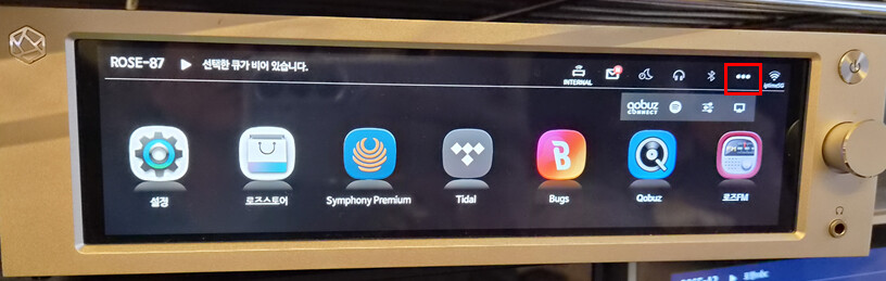

Please try toggling the Spotify service off and back on via the three-dot menu in the upper right corner of the main screen, and then check again.
스포티파이_0710
