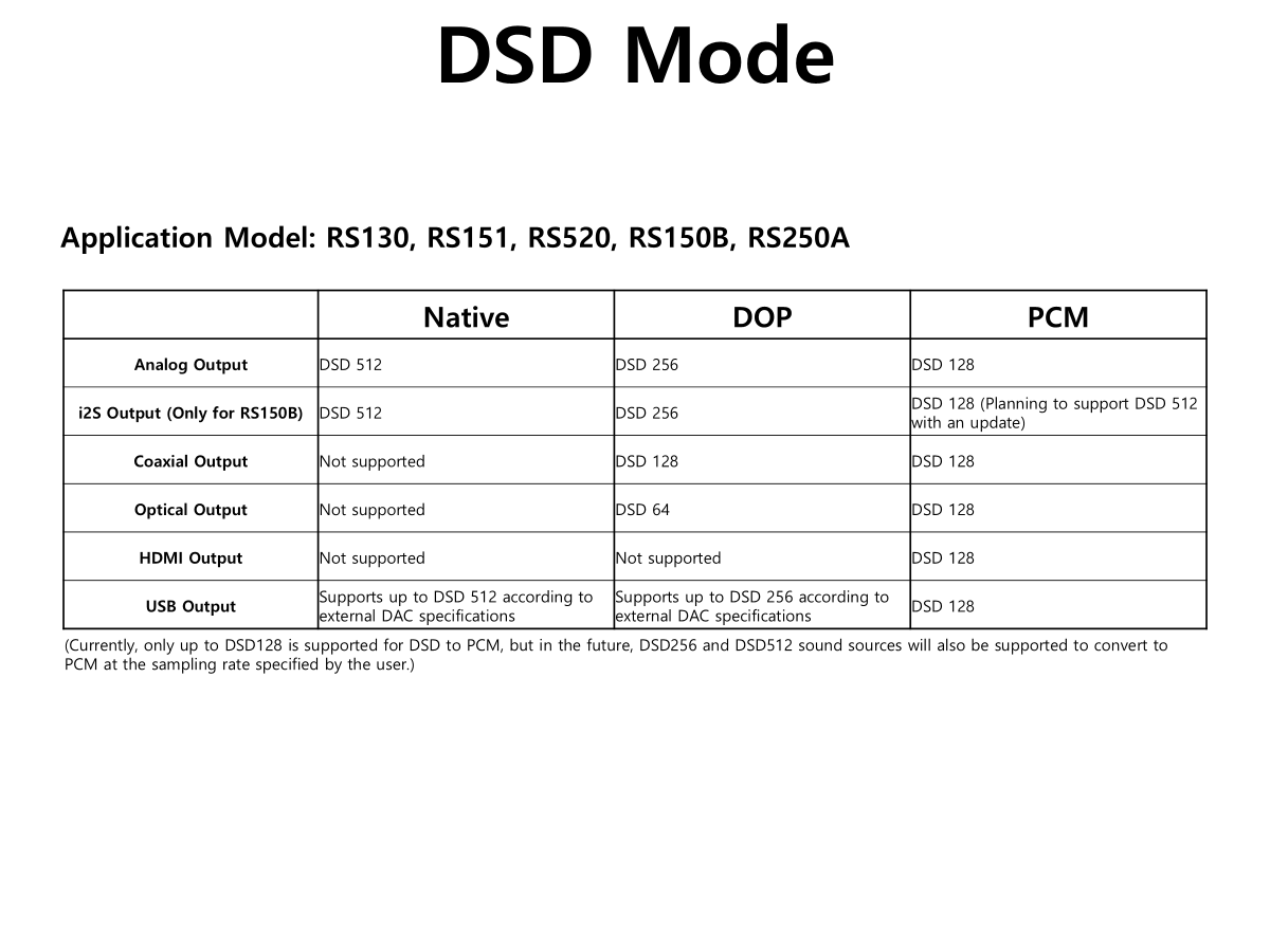

To better understand why your RS130 is not playing DSD files, please help us confirm the following:
  1. What is the format of the DSD files you are trying to play?
  2. Where are the DSD files stored, and how are you playing them? (e.g., internal SSD, NAS, USB external drive, Roon, etc.)
  3. How is your RS130 currently connected to the DAC? (USB, I2S, Coaxial, etc.)
  4. Please let us know the model of your DAC. Does your DAC support DSD playback?
@Borisisdead
As shown in the table below, the supported DSD format varies depending on the output you are using and the selected setting (Native DSD, DoP, or PCM).
When using a coaxial connection:
  • Native DSD is not supported
  • DoP supports up to DSD128
  • PCM conversion supports up to DSD128
If you would like to play DSD512 files, please refer to the table below and use an output that supports the required format.
@Borisisdead
Most network streamers from other manufacturers follow the same structure.
This is not a limitation specific to HiFi ROSE, but rather a fundamental limitation of digital audio transmission standards.
In fact, there are virtually no network streamers that support DSD512 over a coaxial output.
This is not a product performance issue, but a physical limitation of the digital audio standard (S/PDIF).
Coaxial / Optical / AES connections typically support:
→ PCM up to 24bit/192kHz
→ DSD only via DoP (DSD over PCM), with limited support
For example, coaxial output generally supports:
→ DSD64 up to a maximum of DSD128 (or in some cases DoP256) only
