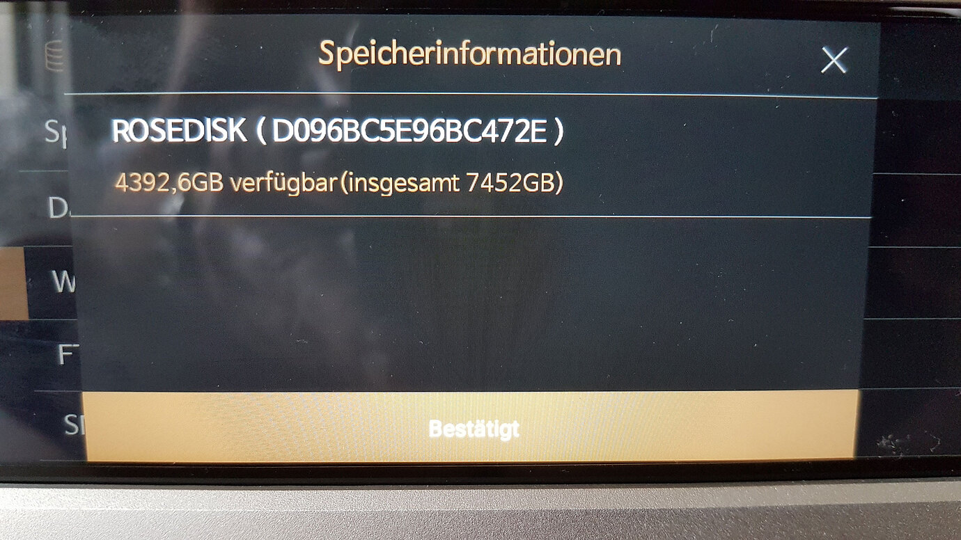

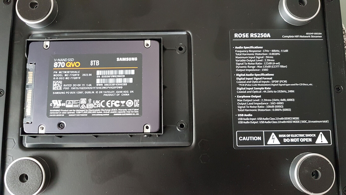

It says in the manual that the Rose RS130 is tested with SSD’s up to 4tb disks. There are 8tb disks avaiable. Has anyone tried one of those in a Rose product?
Some 8Tb SSD works great, like the Samsung Evo. But, Hifi Rose not guaranteed compatibility over 4Tb.

So it is a matter of might work/might not work. Might probably not work on the long term. Is this limit embedded in the hardware of the RS130 (something like data that exceeds 4tb on the disk can not be addressed, I don’t know) or would a firmware update be able to make larger SSD’s work reliably?
I can’t say why some large SSD works and other don’t and even if those that actually works will still in the future. Maybe support from HR could explain more on that matter.
If you look at all of our product manuals, it says that we support SSDs up to 4TB. Of course, larger SSDs can also be supported, but this is not recommended.
