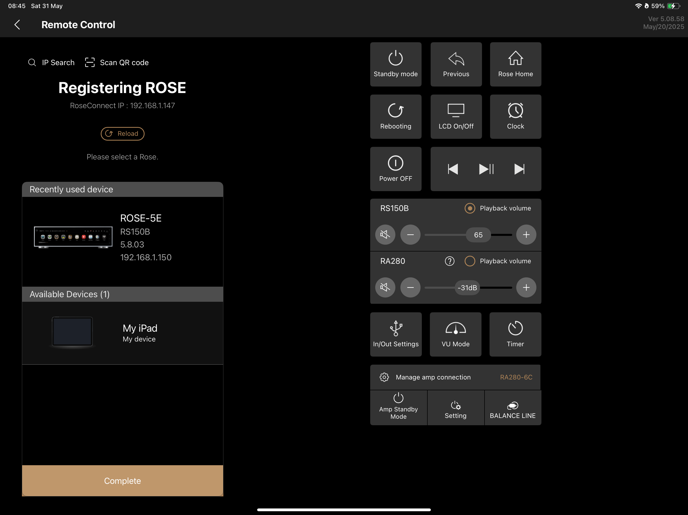

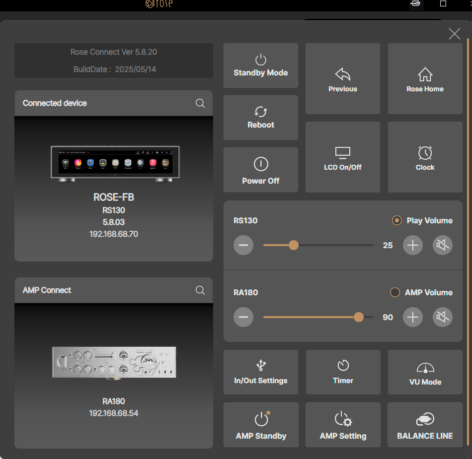

If you go into your Rose Connect EA software, you can click the remote icon at the top right.

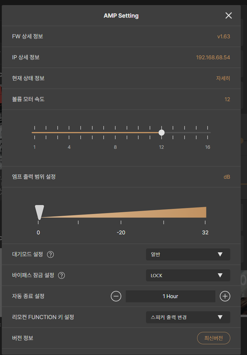

From there you should see an AMP Connect window on the left side. After the update to EA, my amp disappeared. I tried to search the network for it, and it did not find it. Using the RoseAMPConnect iOS app which barely works, i was able to find the IP address of my amp. Manually adding that to RoseConnect EA allowed me to add my amp back. I believe the sync functionality is in the “AMP Setting” menu, but for me, its only in Korean for some reason. lol @ROSEHAN you might want to check this out for the EA build.

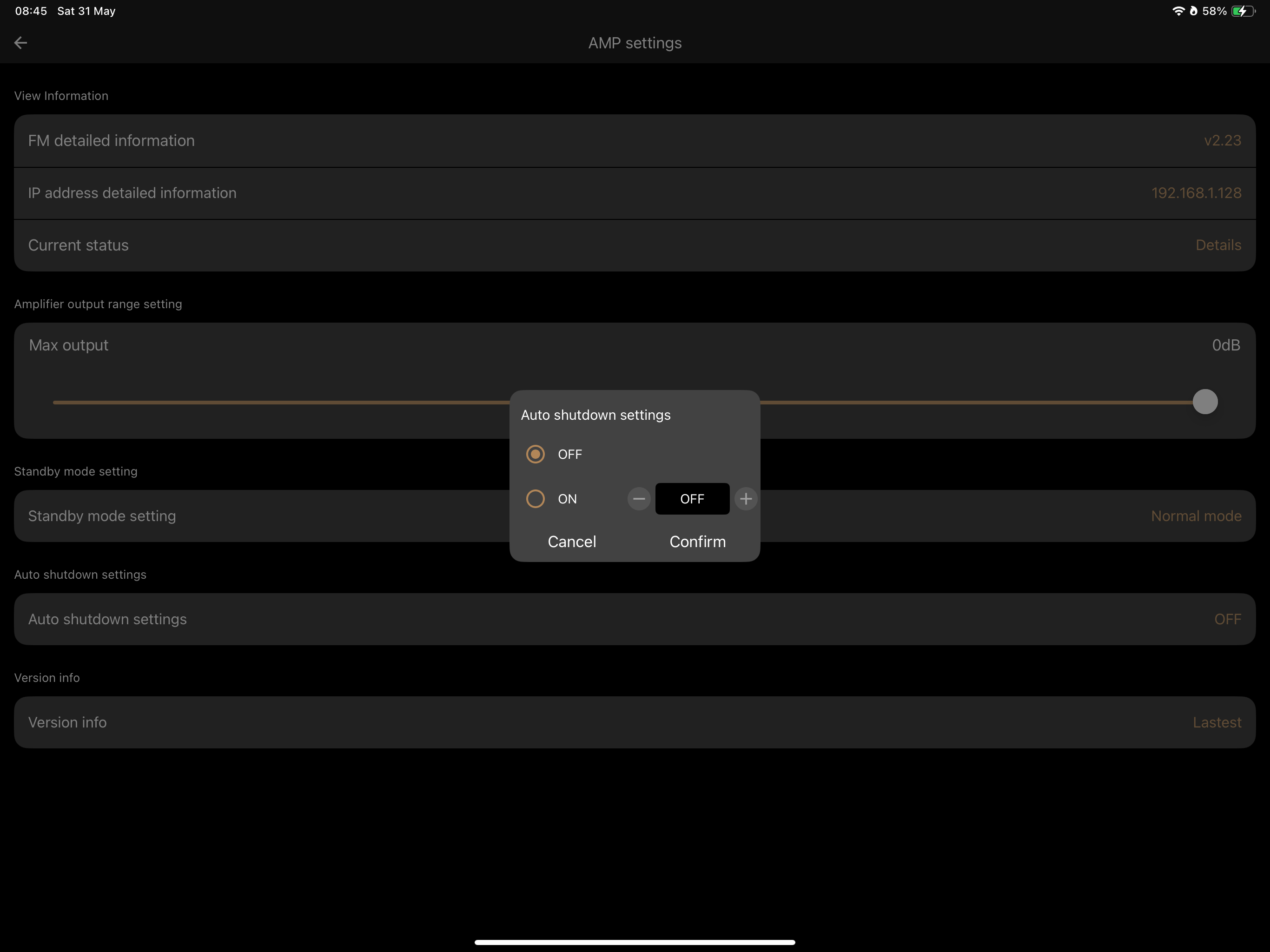

I can see the amp settings but my only options are
Standby mode setting: low power or normal and
Auto shutdown settings: off or on, with a timer selection from 10 mins and upward
There is a difference in that although the amp is on the network as I can control on off remotely I do not see the amp icon under the registering ROSE tab and no amount of searching or putting its IP address works.

What about the Korean text in the EA app that is set to English?
Hi, I didn’t get any Korean text on my control pages
Was talking about my screenshot
@GingerBeard
This issue has been forwarded to the software team.
They will review and fix it.
