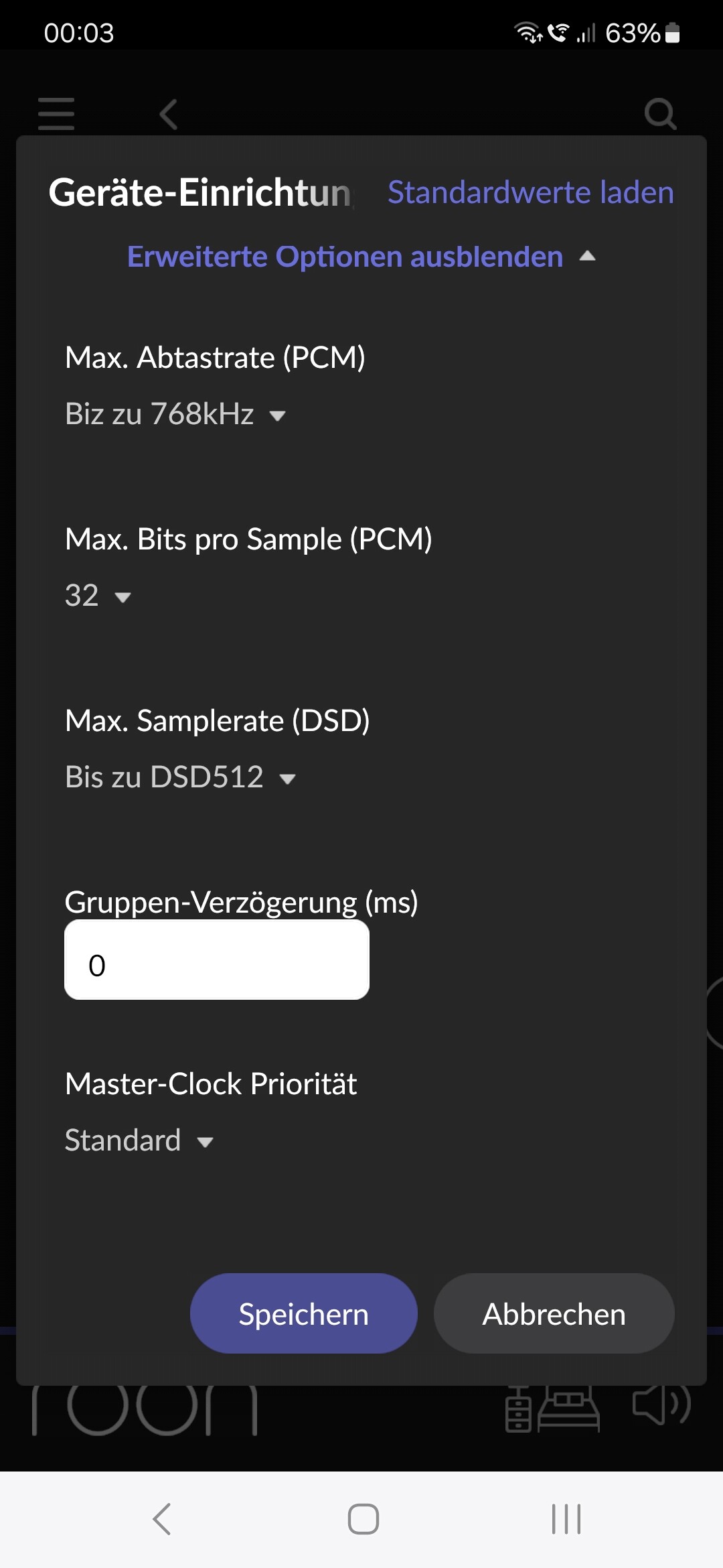

Here for my RS150 on a Holo Audio Cyan2:
So I can set here the Roon upsampling to DSD512 native (no DoP, but native).
