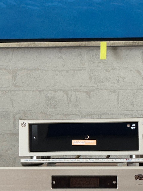

Either my iPhone and 201 shows the Rosetube contents but they just can’t play the video. It always saying it has an error, please try later.

Now I can connect my iPhone to turn on the 201, with Rosetube shows on my phone and the 201 screen but it just can’t play.
Either the circle keep moving or saying :could not play due to temporary error.please try again later !

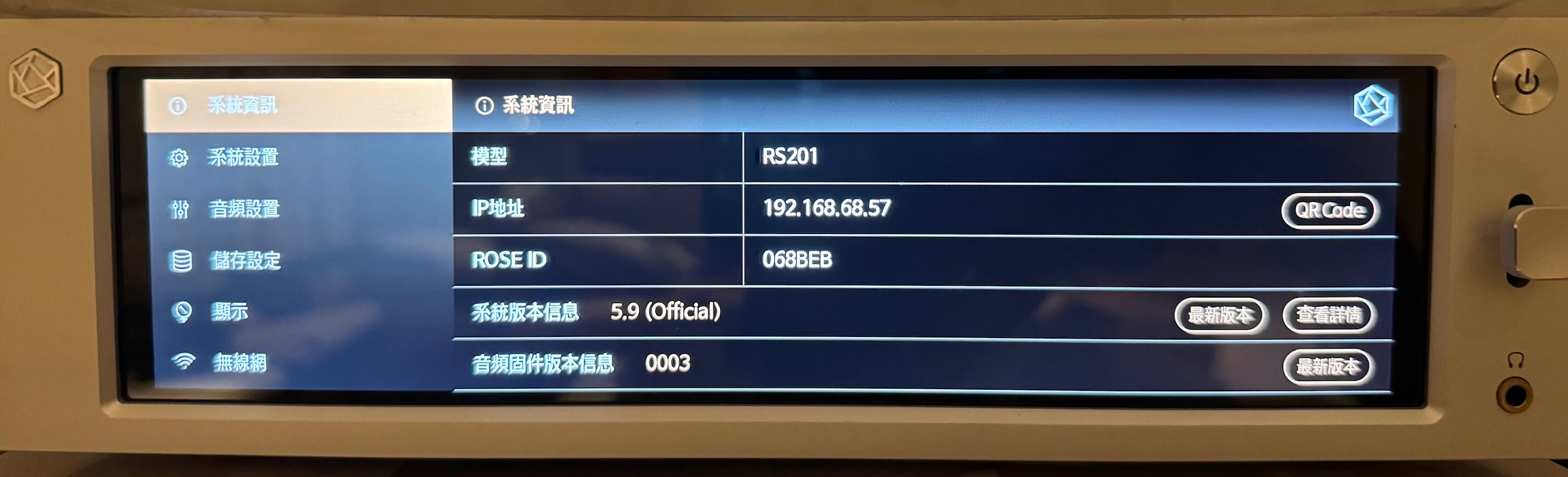

Please let us know your ROSE ID.
You can find it by following this path:
RS201 → Settings → System Info → ROSE ID
yes my Rose ID 068BEB
