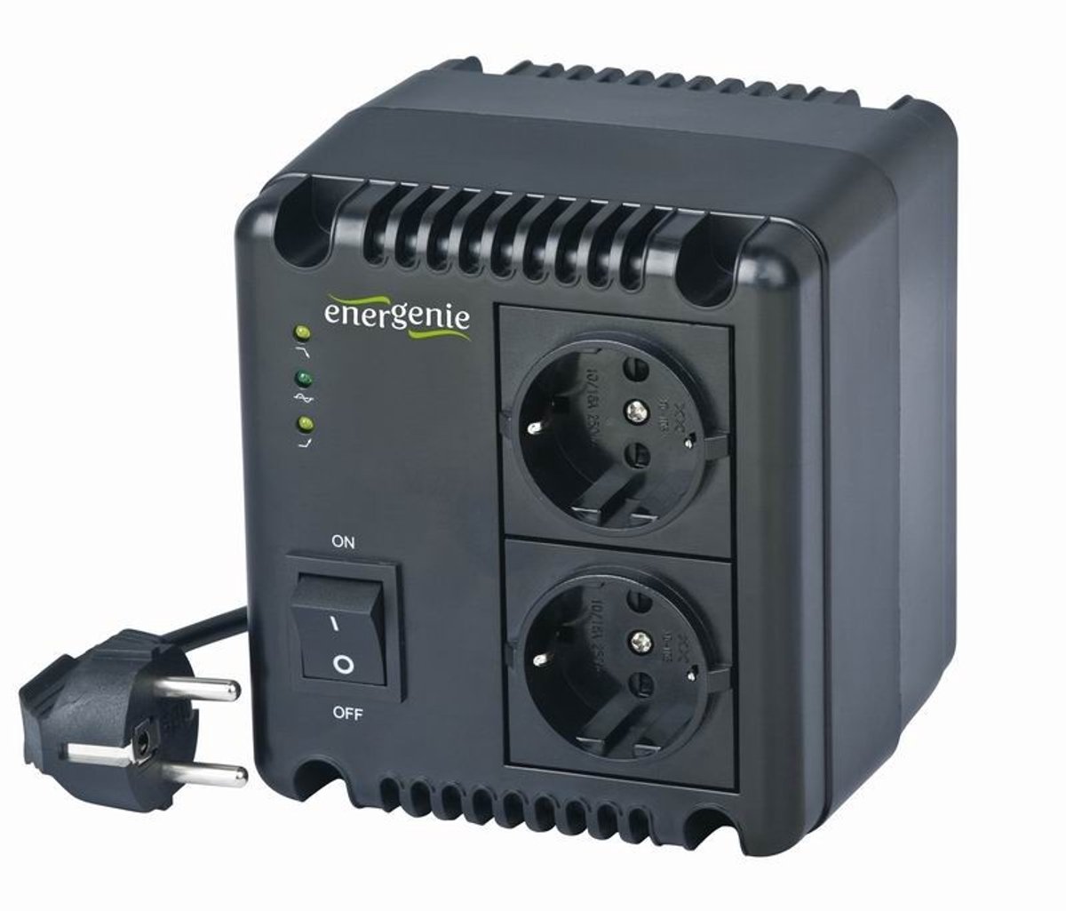

I did post it several times, use a little power stabilisator like in the picture and all your problems are gone.
I had the flickering and black display issues also and after the use of this stabilisator all problems were gone.
I now used my RS130 for more than a year without display issues.
To test I took away the stabilisator last week and connected the RS130 directly to the 220v outlet and the flickering display was there again within few days.
This stabilisator gives a 220v output regardless if the input is between 210 and 270 volt
I’m convinced that the RS130 is very sensitive to high input voltage which can happen if you have solar panels for example.
Just try it, this stabilisator will cost you around 50 euro.
I use my RS130 for 6-8 hours every day and with this stabilisator without any problems.

One would think that a company that was formed around its parent company’s LCD screen technology would know that the screen was prone to damage from voltage fluctuations and spikes and would have built into the unit an appropriate voltage regulator or some other way of dealing with the issue. I am glad this solution works for you Bitspeed.
One would think indeed :slight_smile:
But they didn’t.
I’m for 99,9% convinced it has something to do with these fluctuations but sadly enough I can’t proof it.
But yes, this little hero works for me :+1:
Make sure you buy the right device.
It is not a power filter but a voltage regulator.
Regarding the sound, it has no impact on the sound quality.
At least not for my ears :slight_smile:
