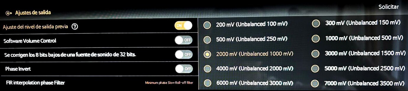

I would like to know how the new software update affects or impacts the PRE-OUT LEVEL SETTINGS and the VOLUME CONTROL. I currently have it configured as shown in the image.
Additionally, I’d like to know whether I’ll still be able to keep this configuration exactly as shown in the image.till be able to keep this configuration exactly as shown in the image.
I’m also sharing screenshots of my current software version and my current audio output configuration for reference.

@JMBARG
Regarding the latest software update, the release notes originally included the item “Added Maximum Volume setting and Startup Volume setting” for the PRE-OUT LEVEL settings and volume control.
However, during the implementation of these features, several issues were identified. As a result, these features were not included in the final software update.
The release notes should have been updated to remove this item before publication, but unfortunately it remained listed by mistake. I have now removed the incorrect information from the Software Update Notice.
Additionally, based on the screenshot you shared, it appears that your ROSE device is currently running the Official version, not the Early Access (EA) version.
The update you are referring to is available only in the Early Access (EA) version.
To switch from the Official version to the Early Access version, please follow the steps below:
Settings → System Information → Use Early Access Version → Try It
