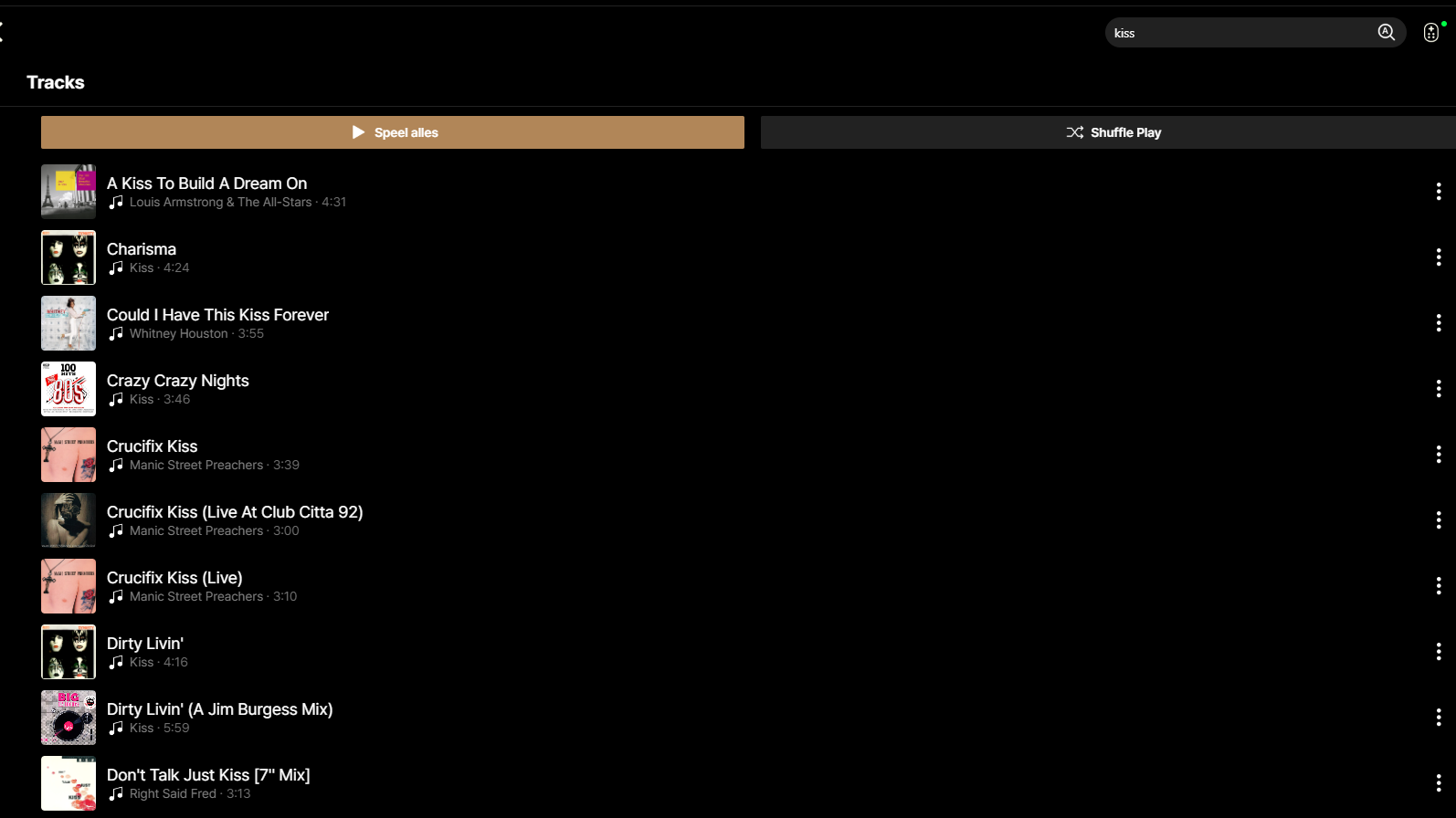

What is strange is that when you search for the track “Kiss”, some of the results shown are tracks by the band Kiss that have completely different titles. See the attached image.

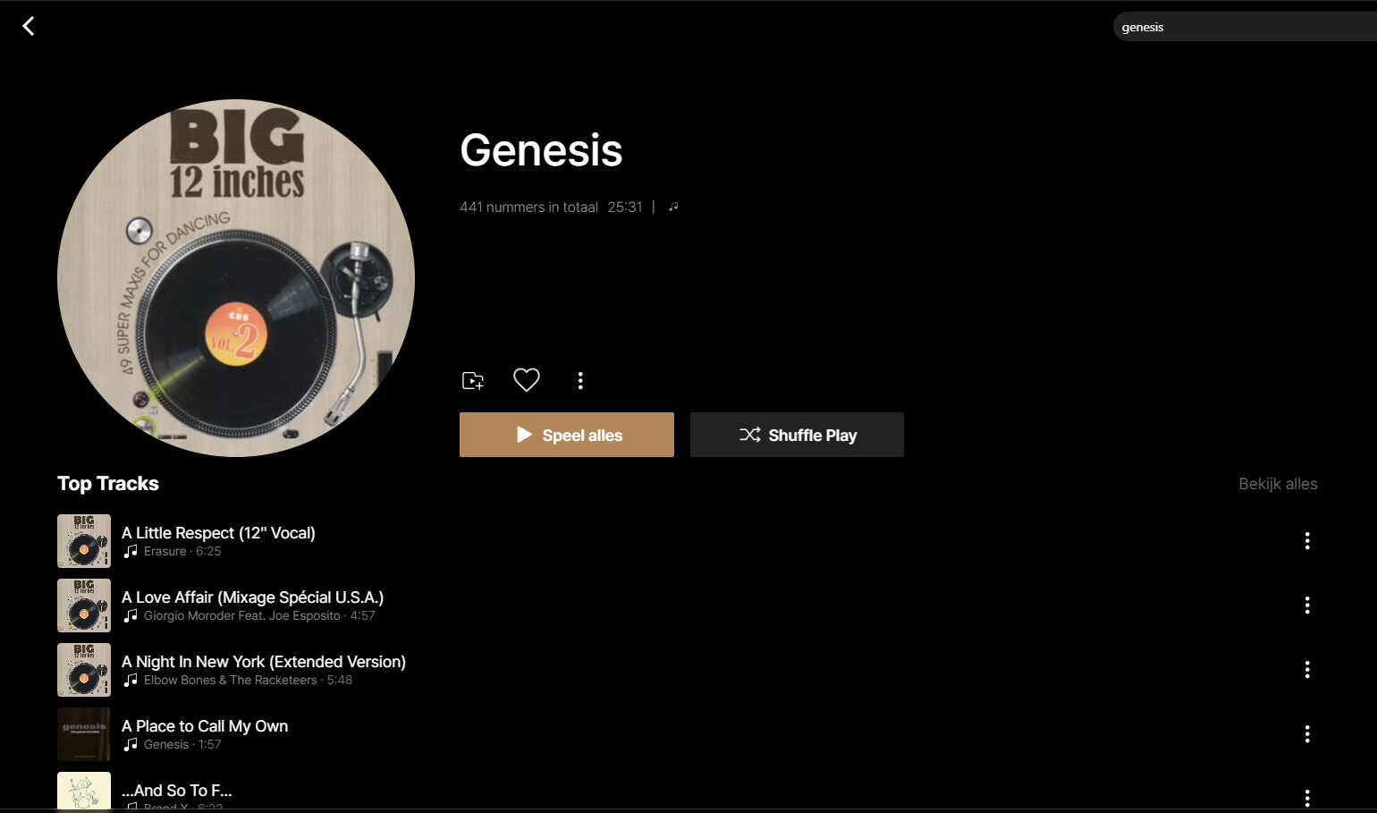

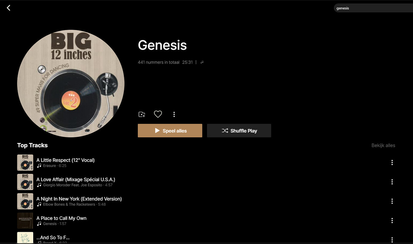

It also seems that a distinction should be made between the track artist and the album artist.
Please see the last image.
