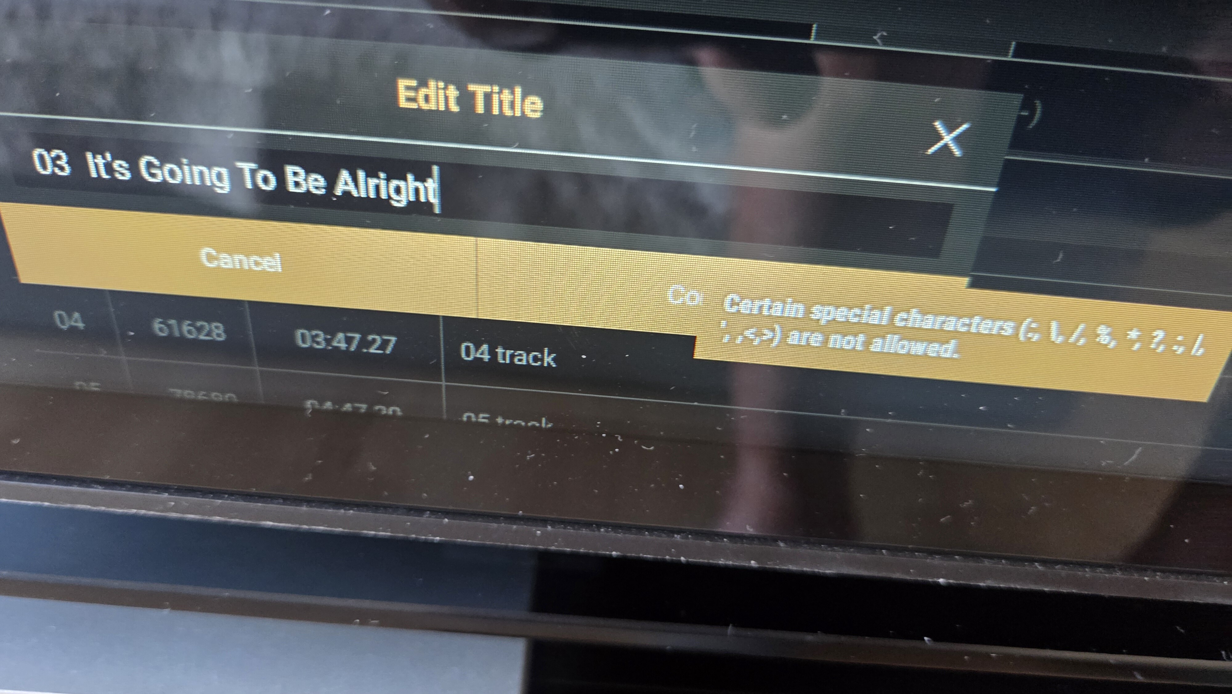

Why is it, that one can’t use special characters anymore, when using the roses own pad to write the tracks? For instance the ’ as you use on almost all English albums… It’ s Can’t and so on… Until a year ago, it was no problem at all… After one of the updates, you couldn’t do it anymore. Was hoping, that it was restored on the new update, but it wasn’t :expressionless:

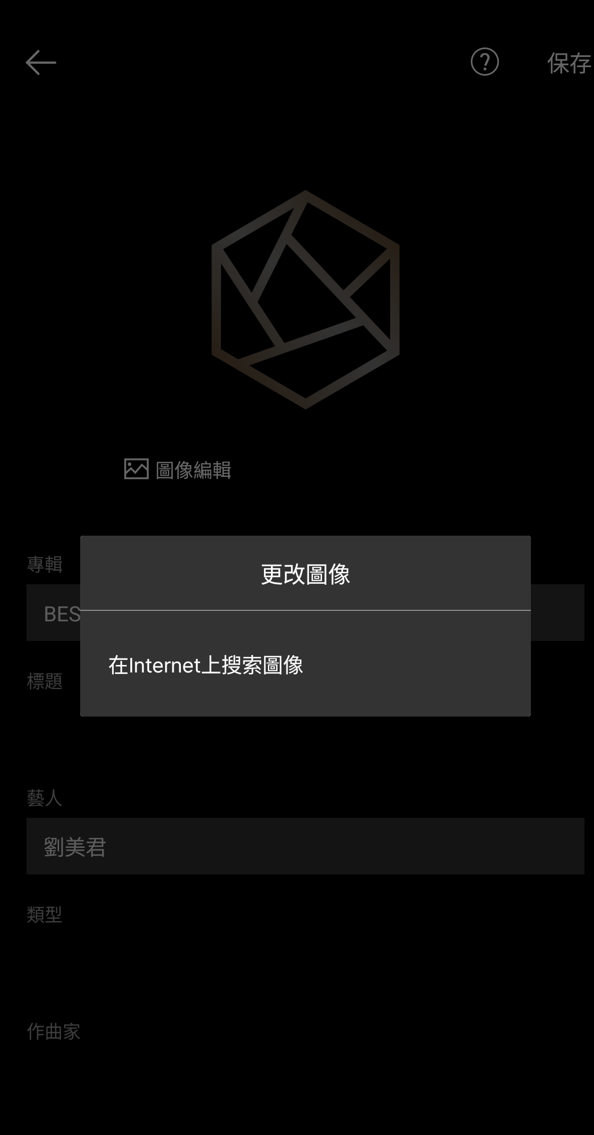

Please help. After updating new version, I am not able to add covers photo to the album from my files in my mobile phones .

Due to an ongoing app review process, there is currently an issue with accessing the photo album when changing profile pictures or thumbnails.
If possible, please use the Rose One app instead.
