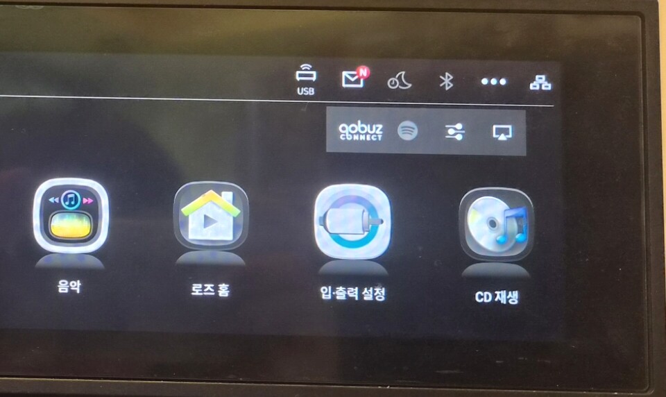

after upgrade to 5.11 my RS130 cant any more airplay!
I installed the latest update on my RS-250 last night. It’s a two-step process: first, the operating system is automatically updated to the latest version, then the Rose Store page pops up, and you have to update each of your installed apps. Aside from having to rearrange the icons on the screen afterward, all settings were applied correctly. Qobuz Connect is also working. In summary: successful.
@TheOne1894
We tested this under the same environment on an RS130, but couldn’t reproduce the issue.
Please try restarting the device and check again. If the issue persists, tap the 3-dot menu in the top right corner of the device screen and make sure AirPlay is enabled.
Airplay
@Matterhorn
Thank you for sharing the update results
@Rose_love
Thanks. i found out, that in the RoseConnect One is not enable. “Airplay 2” → enable and restart the Device. it’s work now.
i cant play all song on the Device RS130 or with RoseConnect One with Apple Music, if they have above 24bit/48khz. Because of that, i play over Airplay 2!

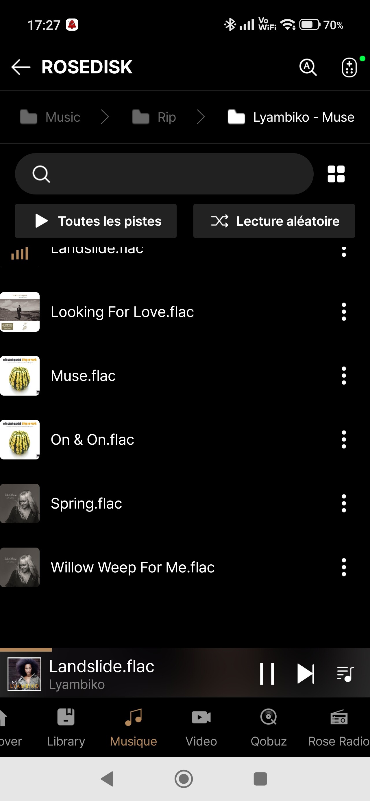

@Rose_love @ROSEHAN
Despite all these recent updates, the same problems still persist…
However, some issues have been fixed, and I want to congratulate the development team.

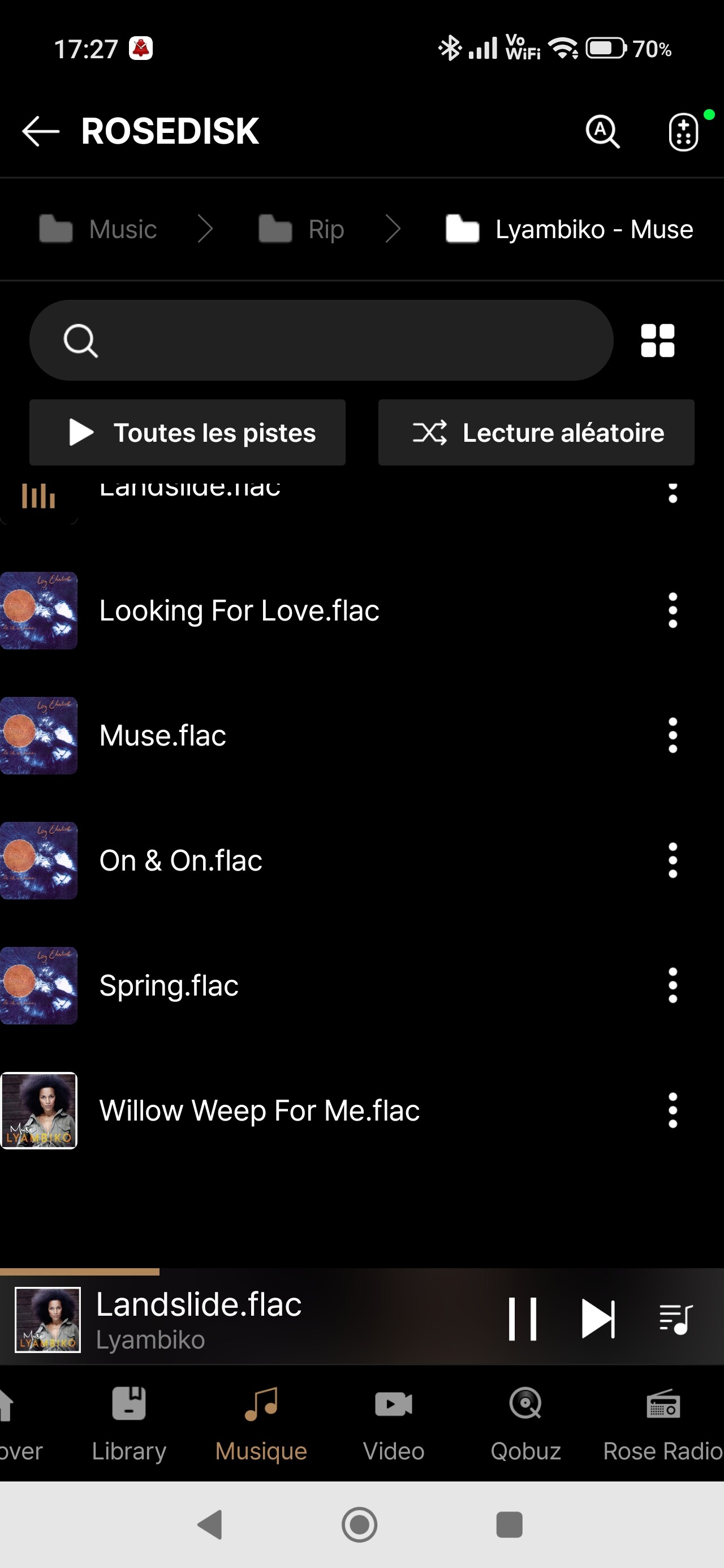

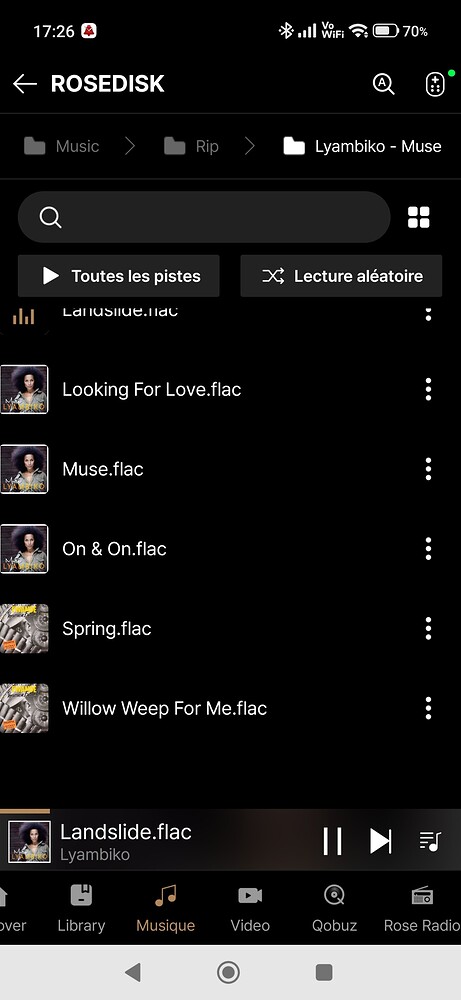

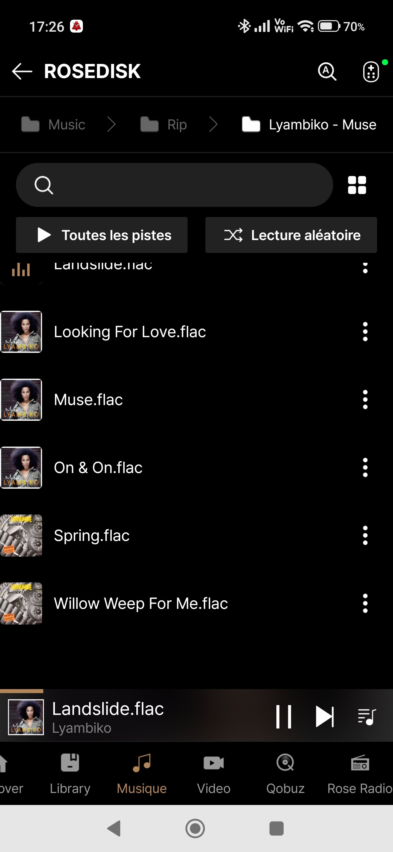

Album covers for albums stored on the internal drive are still displayed incorrectly and don’t match!
If I exit the folder and re-enter it, it gets worse, because they change every time.
It shouldn’t be that hard to fix such a major bug, though.
Here’s an example:
In this example, you can clearly see that it’s the same folder/album.
Every time I open this folder, the album covers change, even though the files are the same.
On the RS151 display, however, the correct album covers are shown.

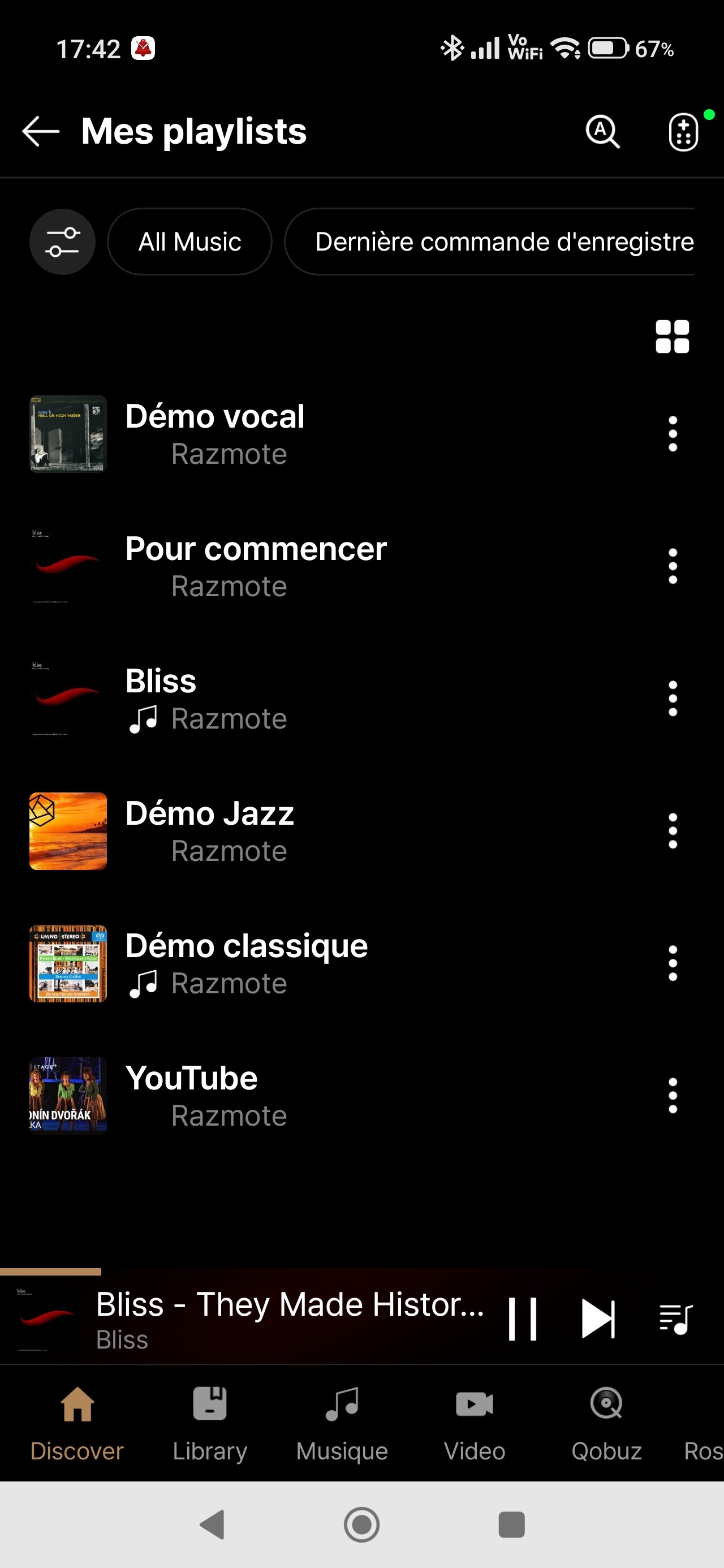

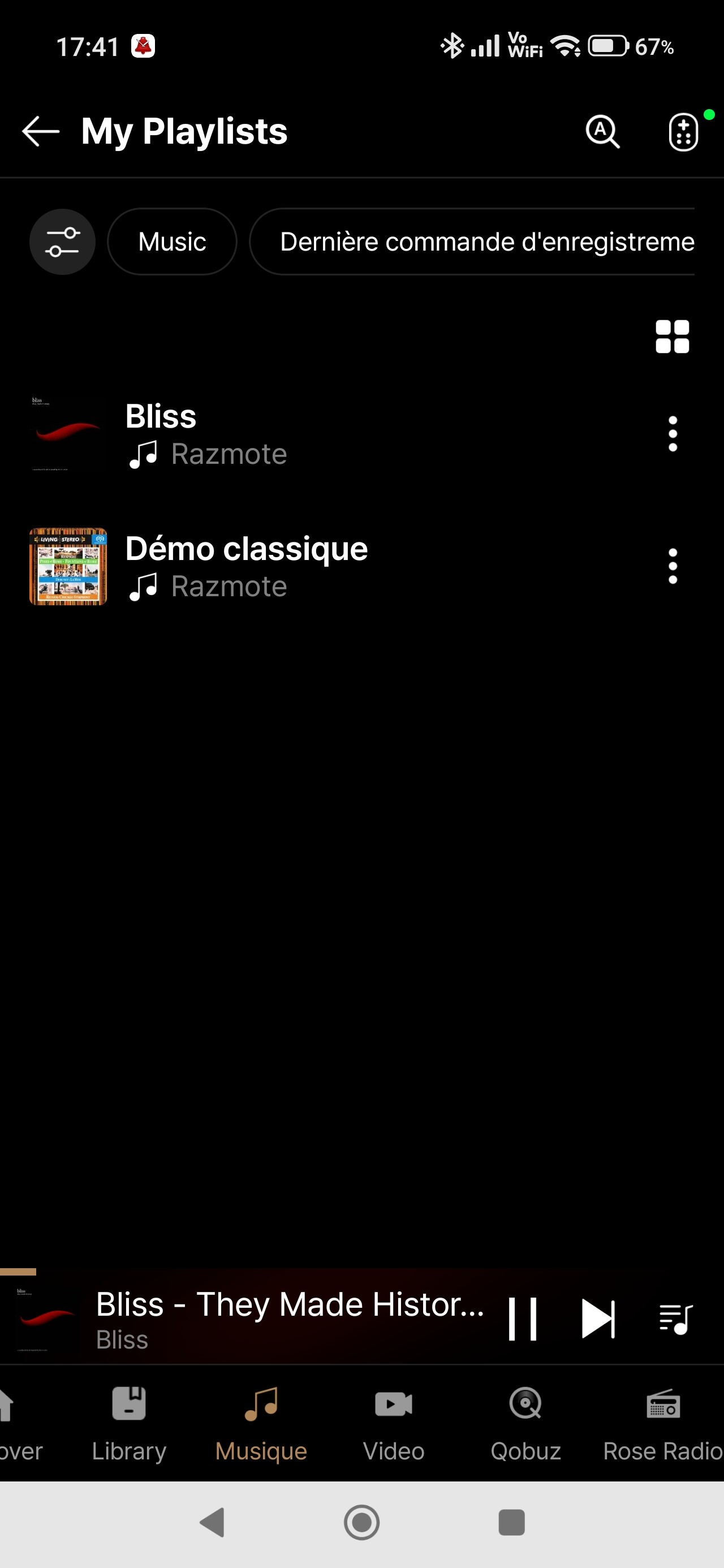

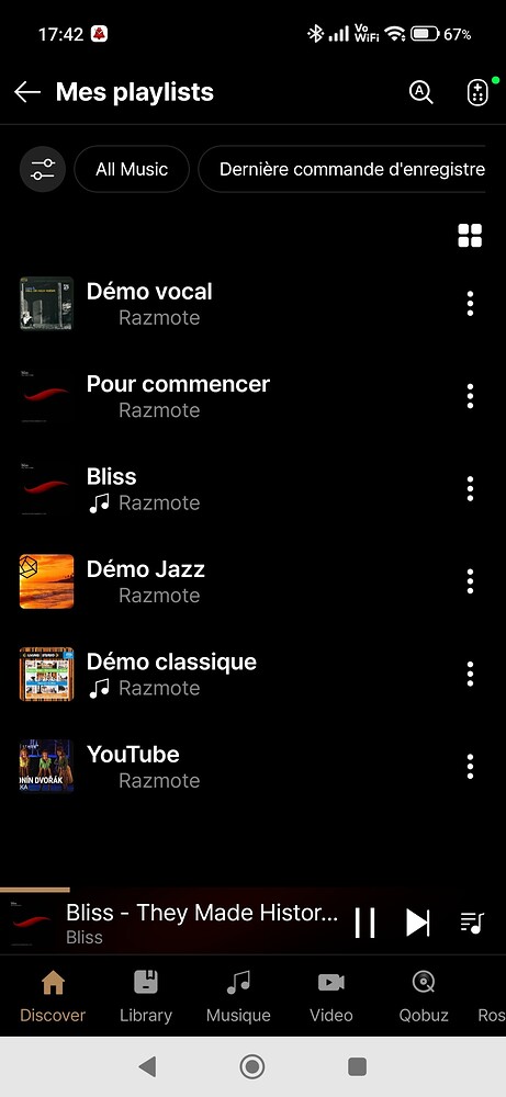

And finally, the list of playlists is incomplete in the MUSIC tab → My Playlist.
However, in the DISCOVER tab → My Playlist, all the playlists are there.
