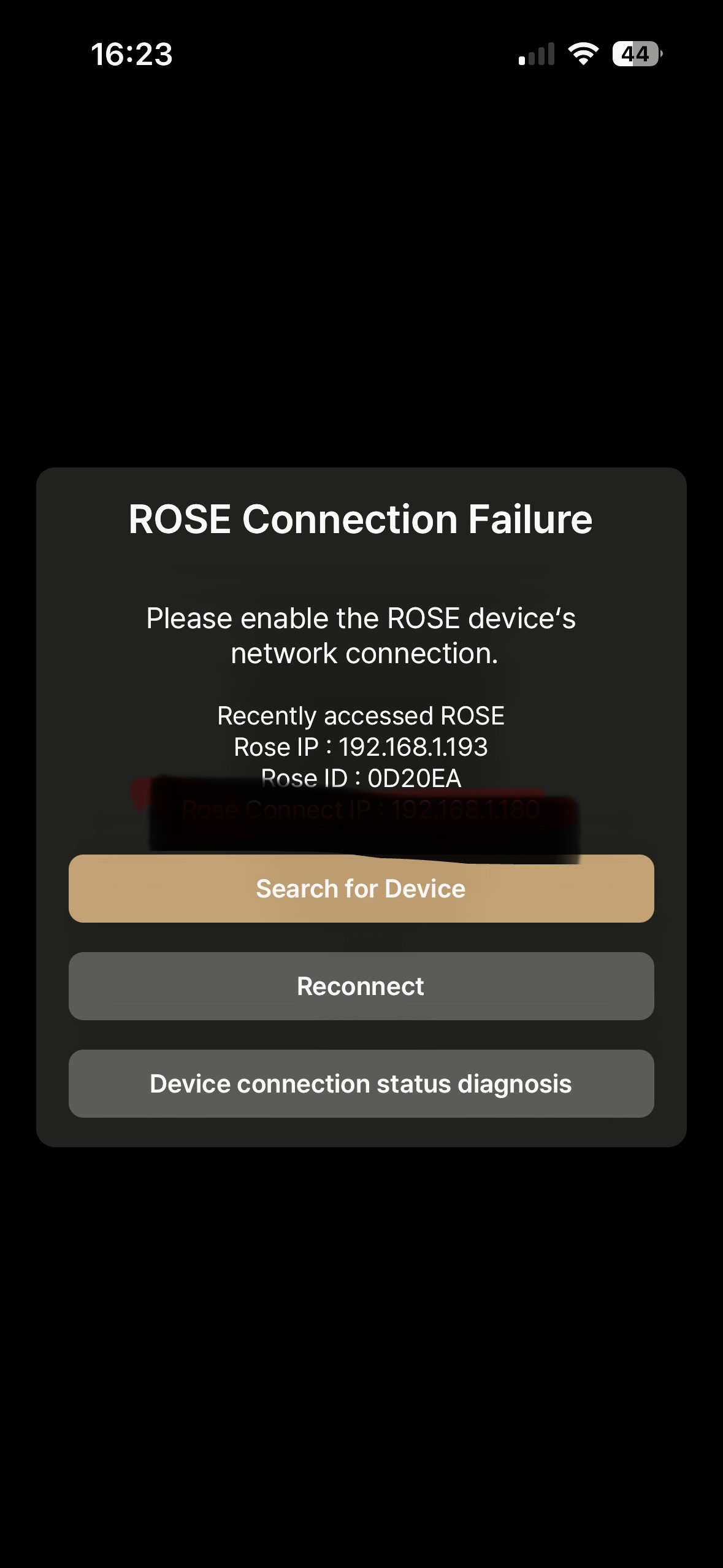

Since I updated my RS520 to Rose OS 5.11.03, I have had a problem when, after activating “ Standby”, via either Rose One, Rose Connect Premium, the supplied Rose Remote Control or the unit itself , the 520 shuts down completely.
When trying to restart via either RoseOne or Rose Connect Premium the following message appears-
I would stress that the issue I have described does not happen on every occasion I shut down but the problem has occurred at least once every two days since the update.
The 520 is connected to the internet via Ethernet cable and all apps etc. are using the same, stable network.
The only way to power up the RS520 is via the unit itself ( as you would do after a normal shut down ).

Check you wifi or Ethernet. Happen to me
@Mrkiss
Thanks for your response. Much appreciated.
I have checked WiFi and Ethernet and, to the best of my knowledge, everything seems to be running fine.
What did you discover when you checked yours and how did you solve the problem ?
I turned of the router. Restart and unplugged the Ethernet plug from the back of the unit. Let it do its stuff. And worked. Check all the cat cables or try another. Mines plugged in not wifi.
@Mrkiss
I did what you suggested ( turned off router, replaced Ethernet cable, switched router back on again) and so far I have not had a recurrence of the problem.
I will let you know if there is any change but, in the meantime, my sincere thanks to you.
