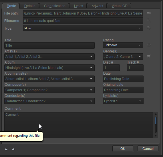

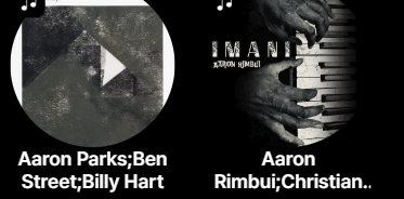

What i still miss is multiple entries in the tags and a seperator sign ‘;’ as can be seen in the screenshot;
For example genre is reduces to one word when it should be several separated entries as can be seen in the screenshot. → Abstract;Contemporary;Ambient should be 3 separate genres not 1. The same goes for all other multiple entries in the tags.
and there does not seem to be a difference between Artist and Album Artist
These tags are the official norm for tagging music files and put them into a DB for search, sort, select whatever.
Thank you for your consideration

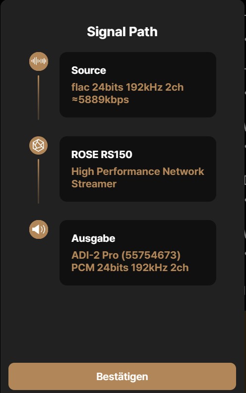

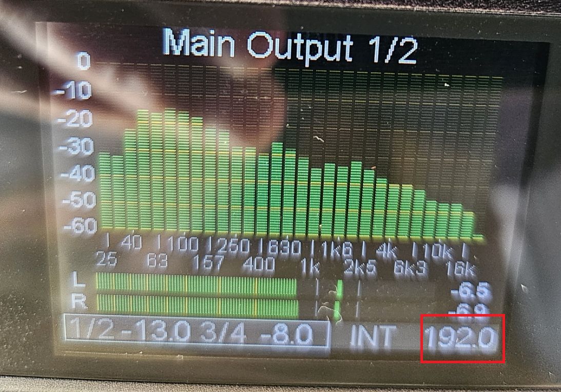

I came back to version 5.9.07 guess why?
NOW after upgrading my 192khz + files play on the RS150B at 96k regardless of in/out setting. I need this fixed or this machine is garbaage to me.
Proble is on both HDM and USB and it won’t even resample to above 96k
@Gillesbonatti : ton pb de DSD natif sur USB est-il résolu ?
How to get previous version?
EDIT: Ahh Ok, 192+… I don’t have it (DXD ?)
That seems to work on my RS150. DAC via USB or I’m misunderstanding something:
SignalPathRS150 ADI-2 Pro
