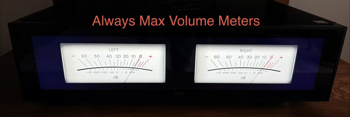

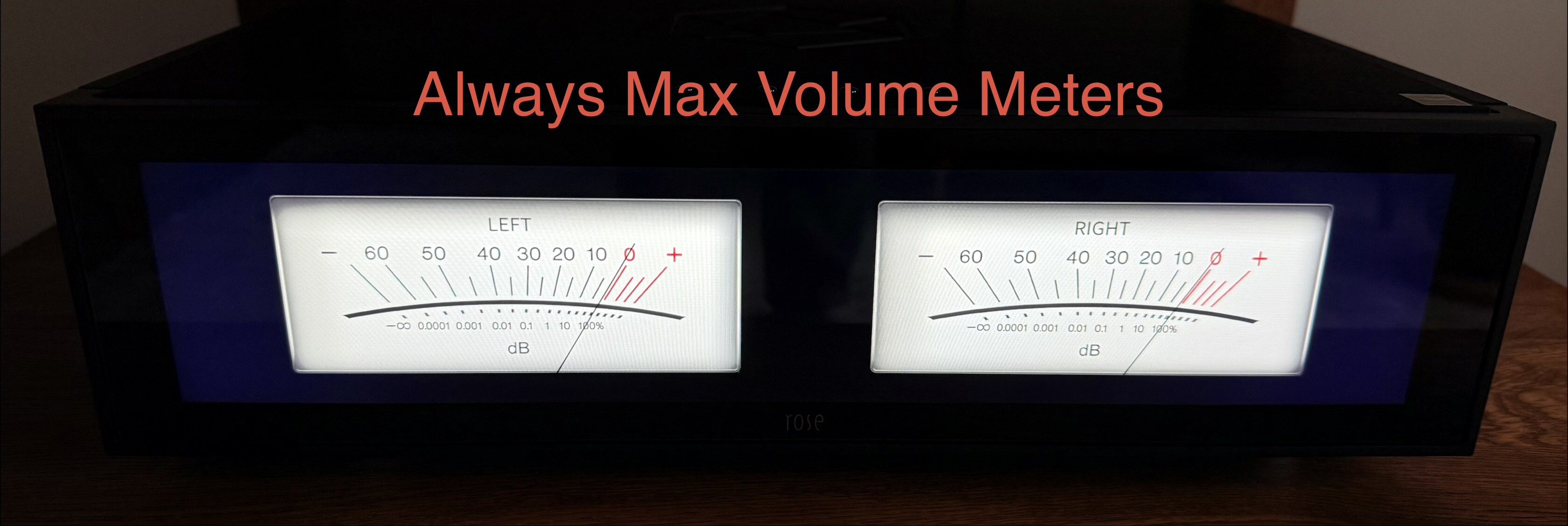

After this update the vu meter are completely in the max output whatever music i play. Before the update is was ok. Please solve

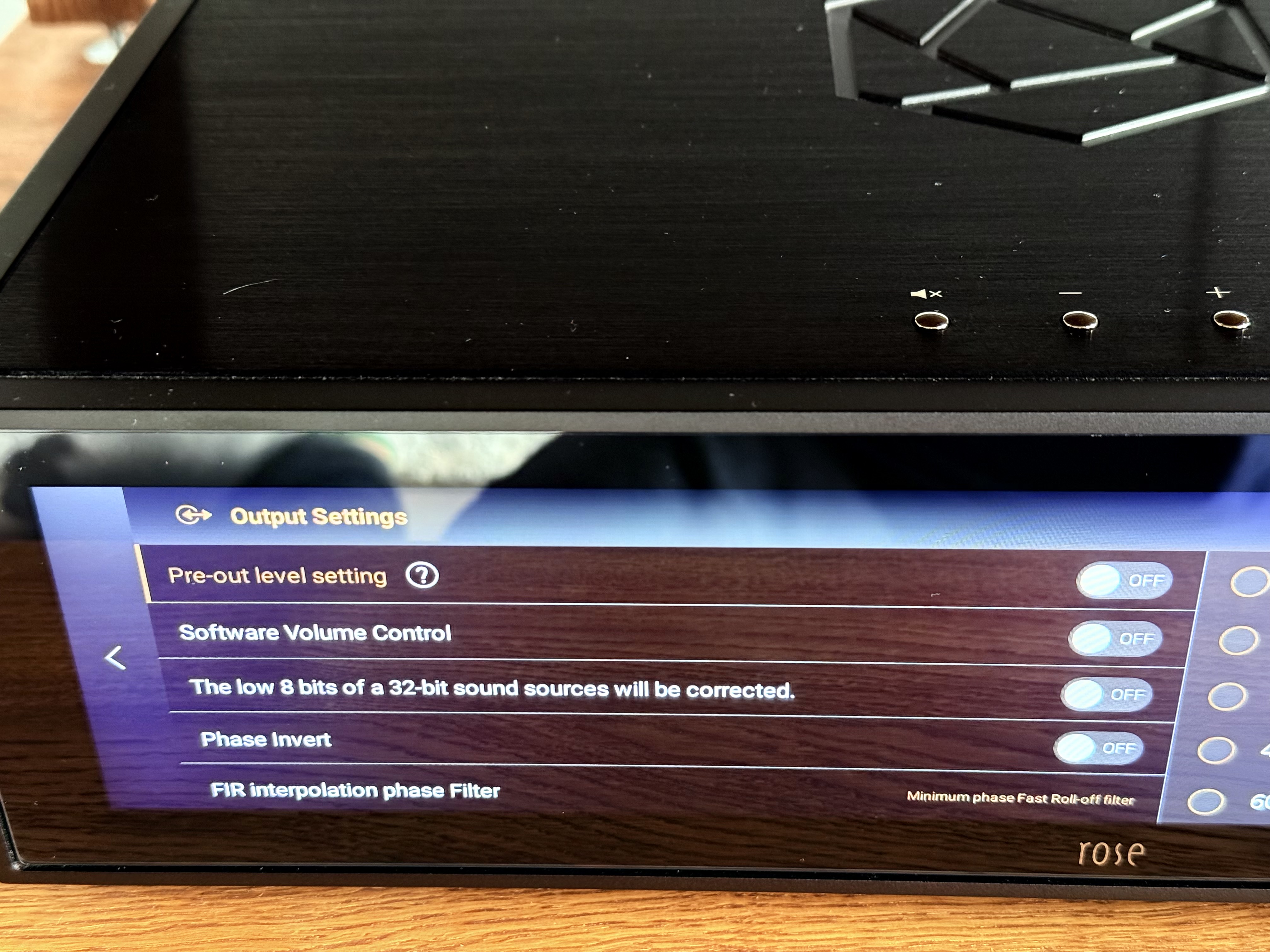

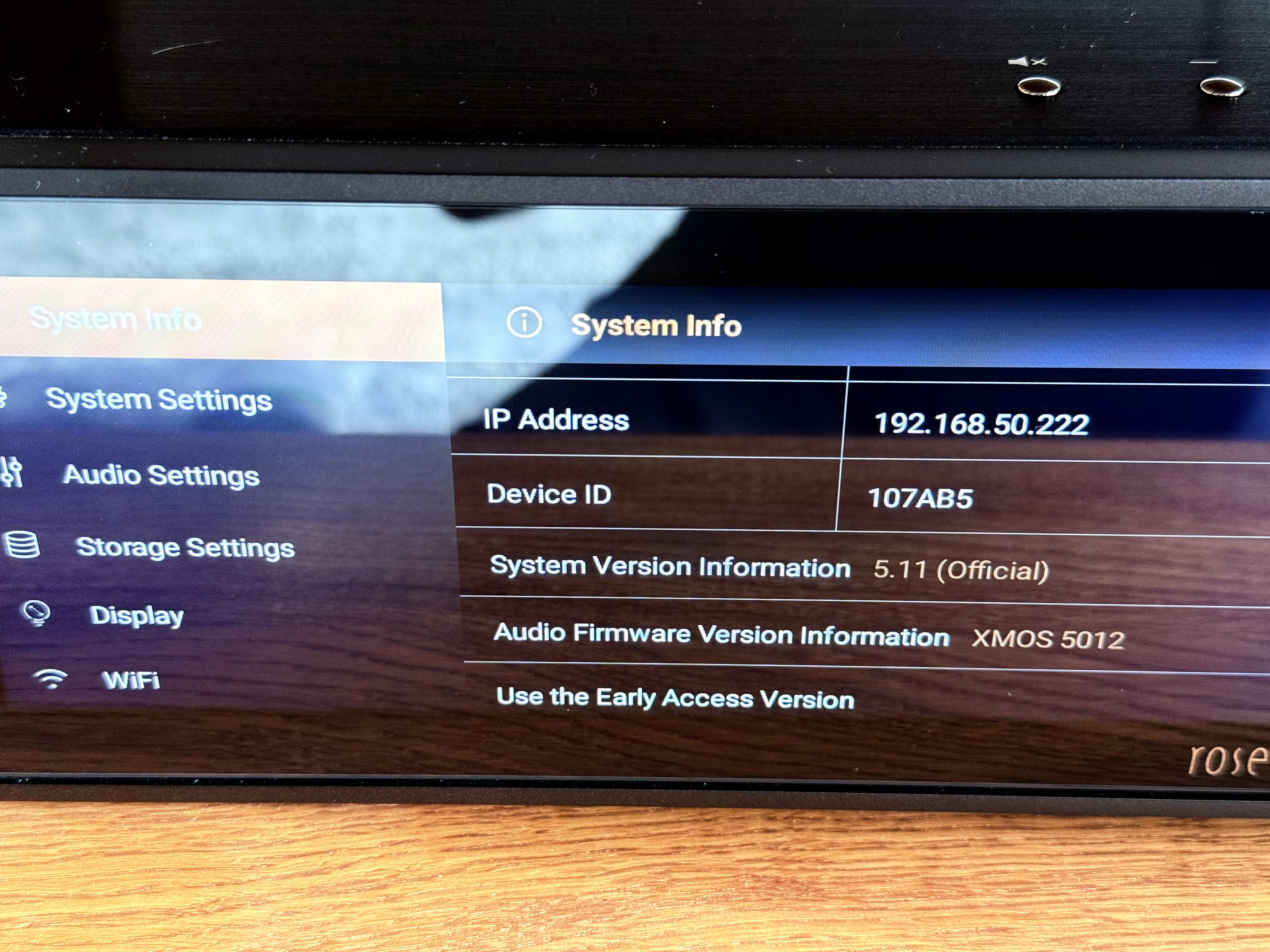

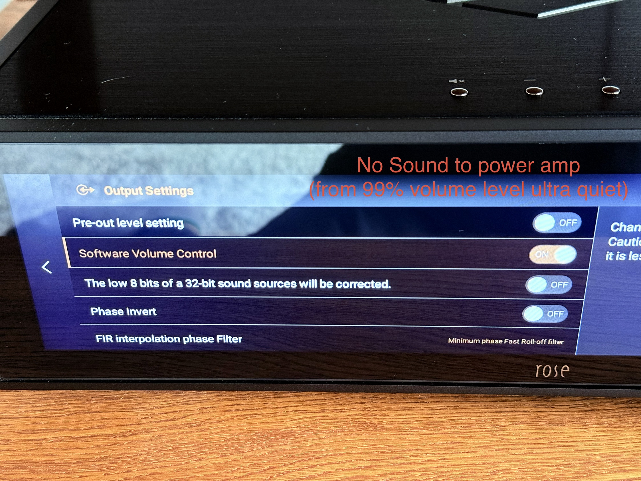

Dear HiFi ROSE Support,
I have discovered a serious and potentially dangerous volume-control problem on my RS151.
The problem started with Rose OS 5.11.07 and remained after updating to 5.11.08. I initially expected 5.11.08 to fix it because its changelog mentions a LINE OUT switching problem.
My setup is:
•	RS151 connected directly to a stereo power amplifier
•	Pre-Out level setting: OFF
•	Analog output in use
With Software Volume Control ON, the sound is sometimes almost inaudible even at 99% volume. Switching from HDMI ARC back to the internal RS151 source may temporarily restore normal volume, but changing to the next track can make the sound quiet again—or suddenly extremely loud. The displayed volume level does not reliably correspond to the actual output level.
With Software Volume Control OFF, the sound returns and the volume can still be adjusted, but the output seems quieter and the sound appears different in quality.
This creates a serious risk of damaging the loudspeakers or amplifier.
I temporarily returned to Rose OS 5.12.05 Early Access, and I cannot reproduce the problem there with the same setup.
Could you please confirm whether this is a known regression in 5.11.07/5.11.08, possibly related to LINE OUT routing or Software Volume Control? Please also clarify what Software Volume Control actually changes for the analog output and whether it should be enabled when the RS151 is connected directly to a power amplifier.

I’m starting to regret spending so much money on this product Shouldve kept my wimm ultra. Every update is a problem :roll_eyes: slow app to use. Vu metres don’t work. They fix one problem and create another. At least all the streaming apps worked on the wimm ultra…hopefully we get a resolution. Otherwise it’s a :lemon: hope someone out there in hifirose management is listening. To me to always have that many updates means there’s a problem with this product.
Lol these VU meter’s are a joke. I turn my volume to zero. They are still showing peak. I changed inputs from setting input. To output no different. Nice gimic hifirose…

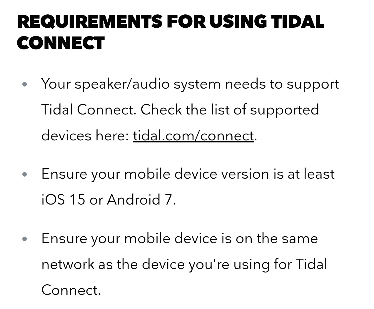

From the official Tidal site:
Screenshot_2026-09-27-16-52-36-08_40deb401b9ffe8e1df2f1cc5ba480b12|1211x1000, 50%
So it’s not the android version

It’s really sad how you all respond. If you would look deeper in wich android version for example the RS151 runs you would see it’s not the 7.1 like some members say. Its a shielded AndroidOs 12 version.
