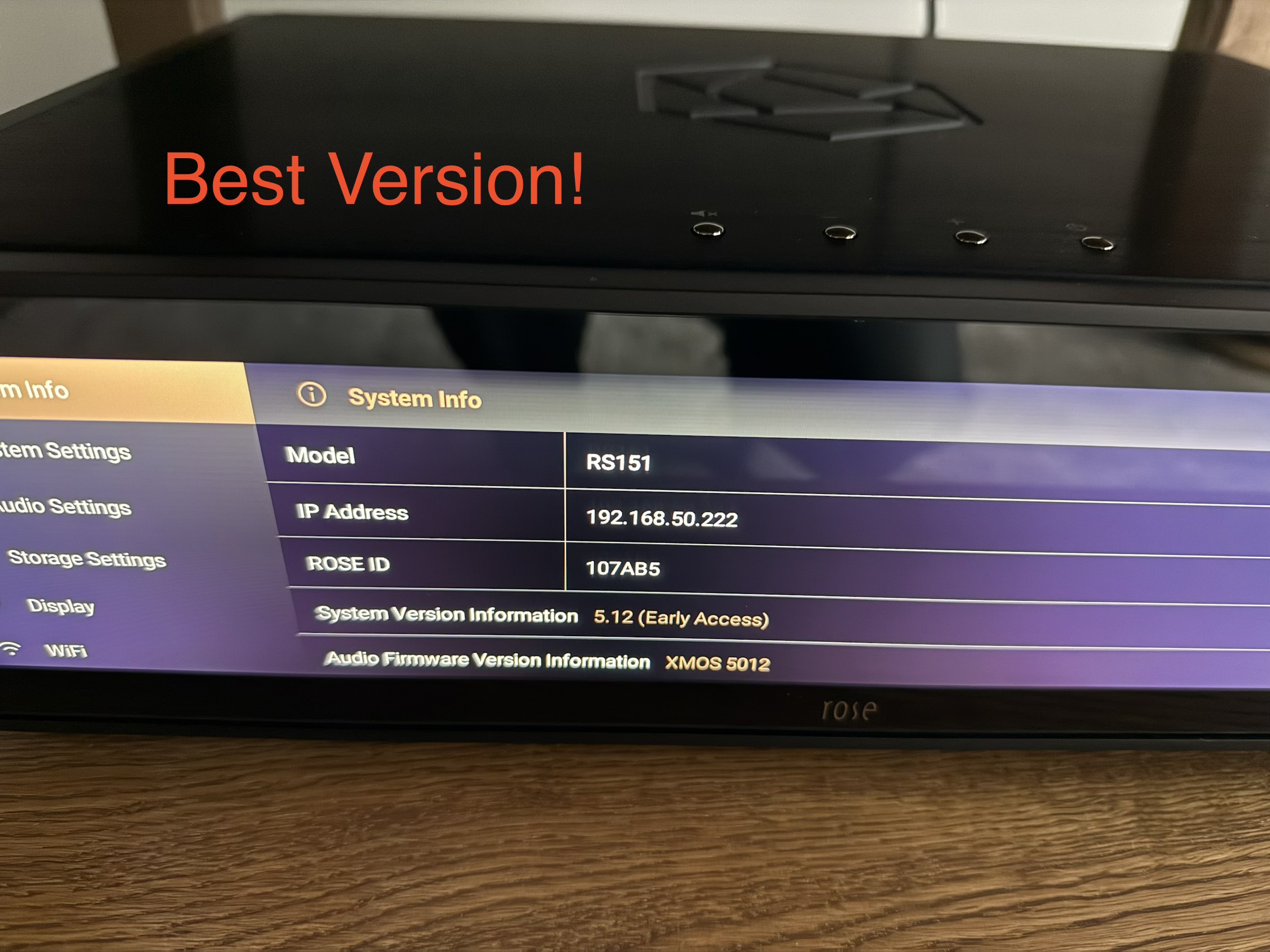

An absolute disaster! It’s going from bad to worse; I have no intention of updating my RS151—my current software version makes it run like a fighter jet!
