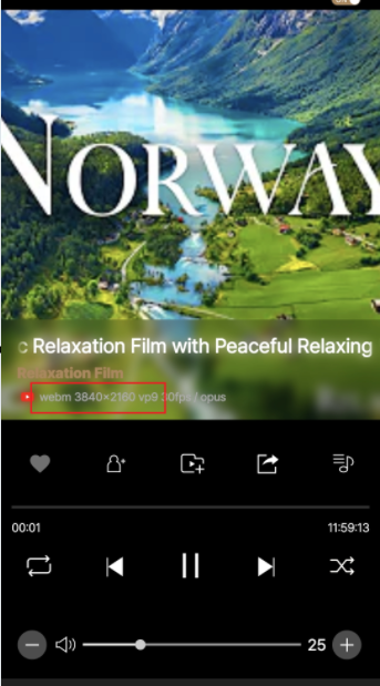

To verify if you are playing in 4K (2160P) on the RS130, check if ‘3840X2160 VP9’ is displayed on the RS130 playback screen. Alternatively, if it is displayed as shown below in the Rose Connect app, you can confirm that it is playing in 2160P
