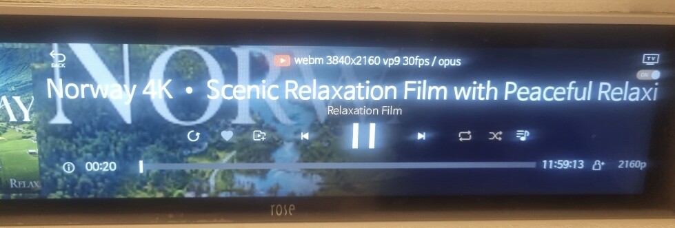

When connected to a 4K-supported TV via HDMI and the TV is powered on, Rose Tube plays in its original 2160p resolution. Please refer to the details below:
1. Playing video with the TV turned on:
  • As shown in the image below, the video plays in 2160p resolution.
2. Playing video on the Rose device’s built-in screen:
  • Due to the smaller LCD screen size, it is difficult to visually distinguish the difference even at 2160p. To avoid unnecessary high data traffic, the resolution is optimized to 1080p for playback.

Thanks for that information. I’m still confused though. If on you tube, rose tube a video is available at 4k or 2160p. Will it play out of the hdmi connector at 2160p.
I think you are saying yes it will. But that on the rs130 screen, the tiny screen on the unit itself, it’s been reduced to 1080p?
Also I’m saying that you tube often will reduce the bit rate automatically by itself to 1080. Even though it is content at 2160. Then you can go on you tube and force it to be 2160p. But on the rose tube interface you can not force it, because that control selector does not exist. It does exist on Apple TV box.
You should add that control. But it may not be possible since you do not pay you tube.
The point is that tidal videos always play full bit rate out of the hdmi, and rs130 displays it beautifully.
But on rose tube hdmi connector output, it’s not always 2160p because you tube randomly reduces the bit rate automatically to 1080p. And then rs130 plays it fine, you can barely see that it is not full bit rate, it’s noticeable.
There is no way to know if rose tube has accepted 1080p from you tube? There is no screen indicator it always says 2160p on rs130 settings/display. And hdmi and tv says it’s 2160p. But the thing is you tube already reduced it when it processes. Rs130 and rose tube can’t display this and may not know.
So people watch videos on tidal for full bit rate always. Rose tube is often reduced bits and you have no way to know, other than seeing picture a tiny bit softer with very slightly reduced contrast.

When the RS130 is connected to a TV via HDMI and you play a video through RoseTube on the RS130, the video will automatically be output at the highest resolution supported within the limits of that specific content.
However, the maximum supported resolution and video quality may vary depending on the individual video uploaded to RoseTube. For example, some videos support 2160p (4K), while others may only support 1080p or lower.
In all cases, playback will occur at the highest resolution supported by the video itself.
