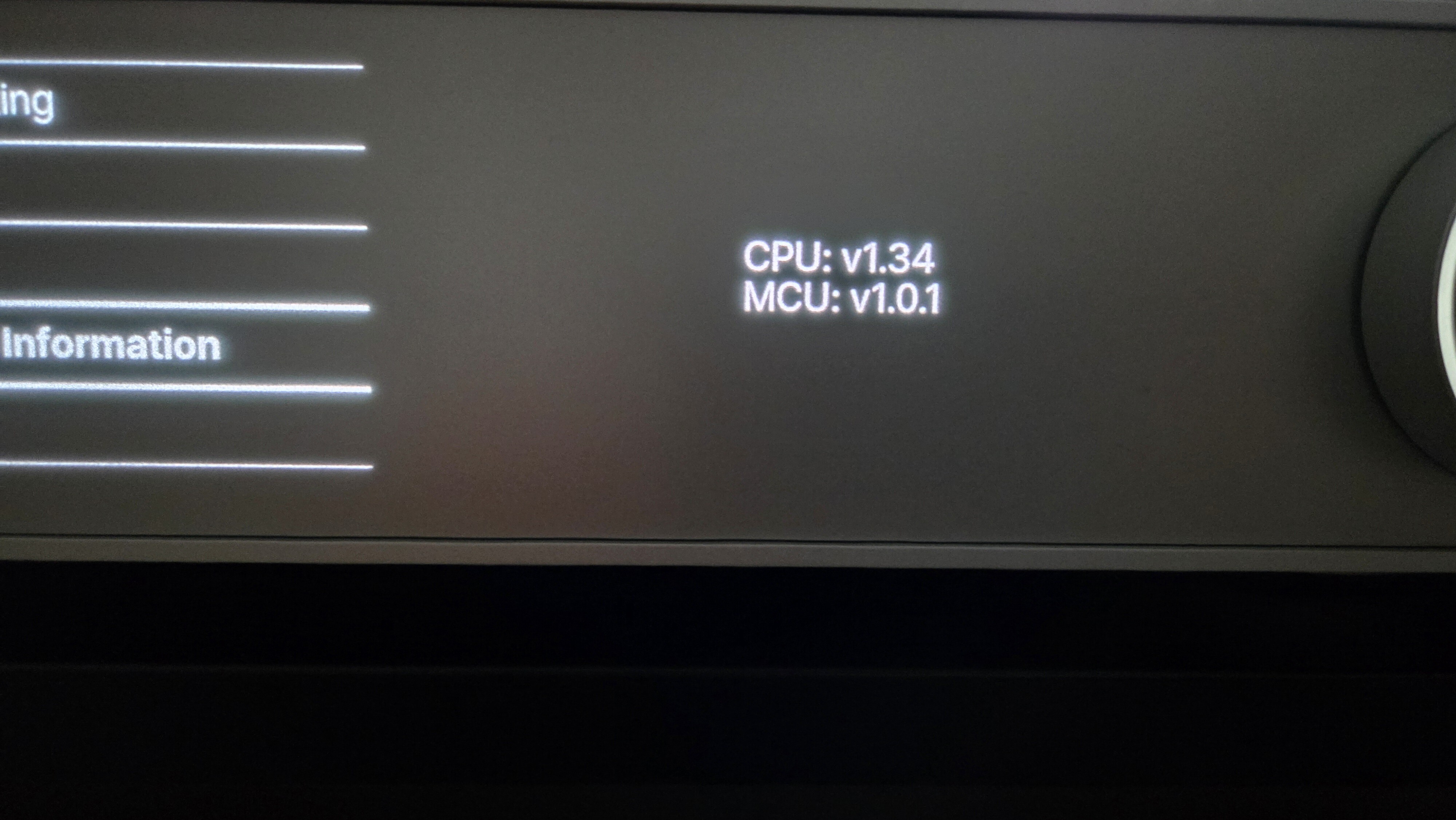

Thanks for your reply.
Just to clarify: I’m already on the latest official firmware (CPU v1.34 / MCU v1.0.1) and have performed the tests multiple times, also with a replacement RD160 from the same production cycle (11/24, MUSE OPAMPs). I’m fully aware of the regular update process and no additional “audio firmware update” has ever been communicated to customers.
If you’re referring to an internal or separate firmware for the DAC section, please provide the exact version number, download source, and installation instructions – otherwise I have to assume we’re talking about the same firmware I’ve already installed.
