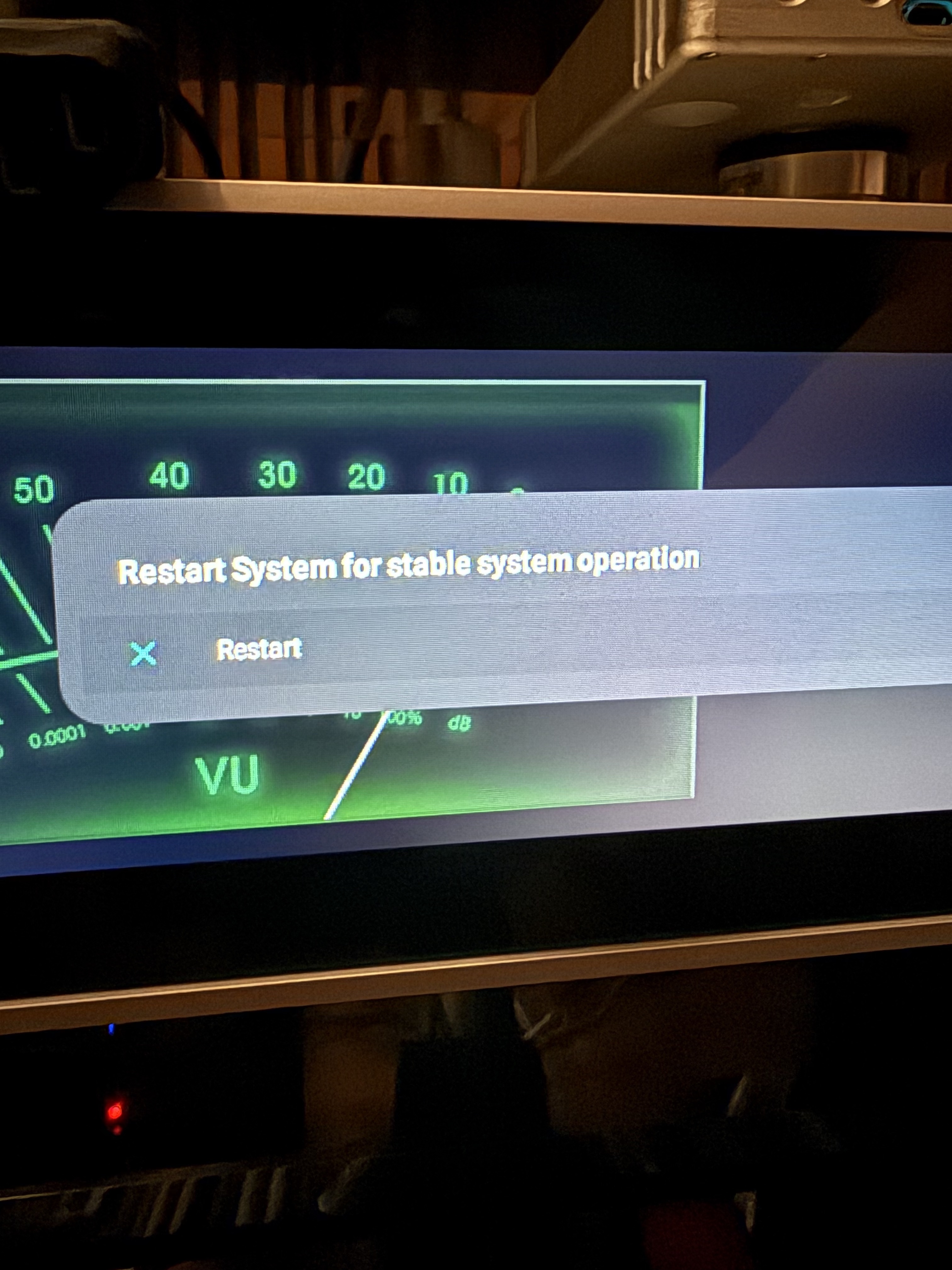

Restart System for stable system operation Error
I’ve been getting this error since last update. Every time I change mode or change input, this will appears.
RS150
Please advise.
