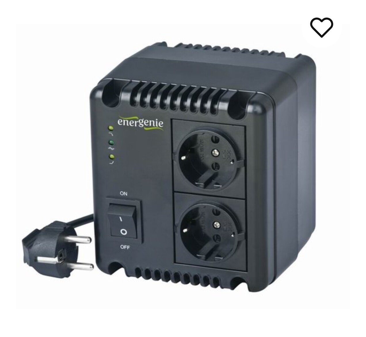

I had a lot of issues with my RS130 like black screens, flikkering screen, very slow response etc.
6 months ago i bought a little voltage regulator which keeps the output voltage at 220 volt regardless of the input voltage which can be between 220 and 270 volt.
It can be a coincidence but after the moment I put this regulator between the mains output and the RS130 I don’t have any problems anymore.
And I use it a lot, mostly for more than 8 hours a day.
I think the RS130 is very sensitive concerning the input voltage.
Just a guess…
