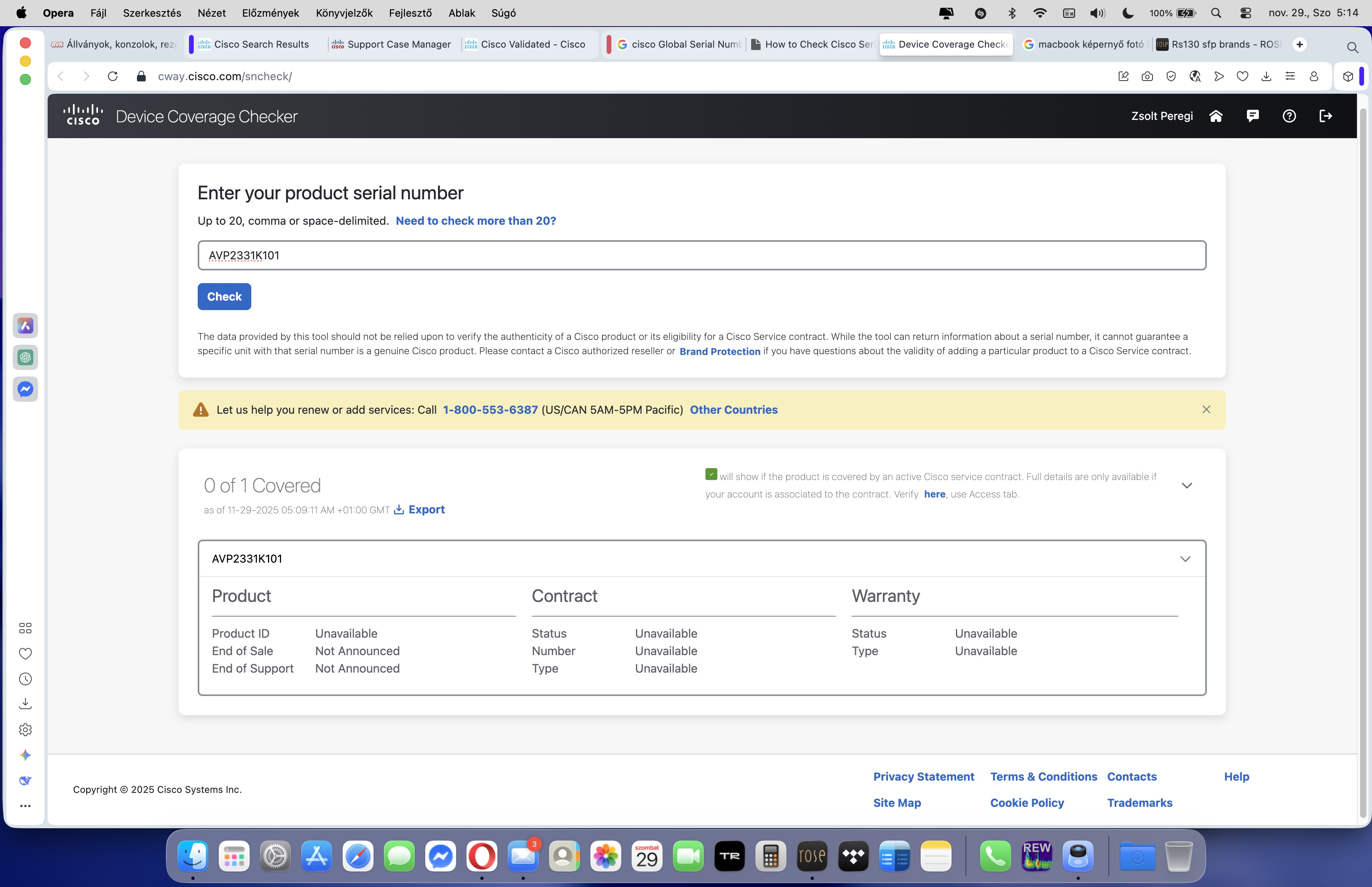

I ordered the Cisco SFP cable from the ebay address you provided, which does not work between rs130-rd160. I checked the serial number and it is not in the cisco serial number verification database, so it is most likely a fake.
If you canāt connect with this, then how does it actually work? Because this is pretty bad!!! The whole Hifirose product is a big disappointment, that it canāt communicate with each other, only with some special cable!!
What solution is there???
