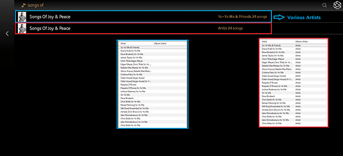

Additionally, regarding what you mentioned about Various Artists, is this what you are referring to as shown in the picture below?

With regards to your picture, it’s partly right and partly wrong. The album becomes listed under one artist but it will choose one from the list, so in your example the album might all be listed under Dave Brubeck, and will only show up under his artist profile, even though there are other artists associated with the album. I hope that makes sense!
