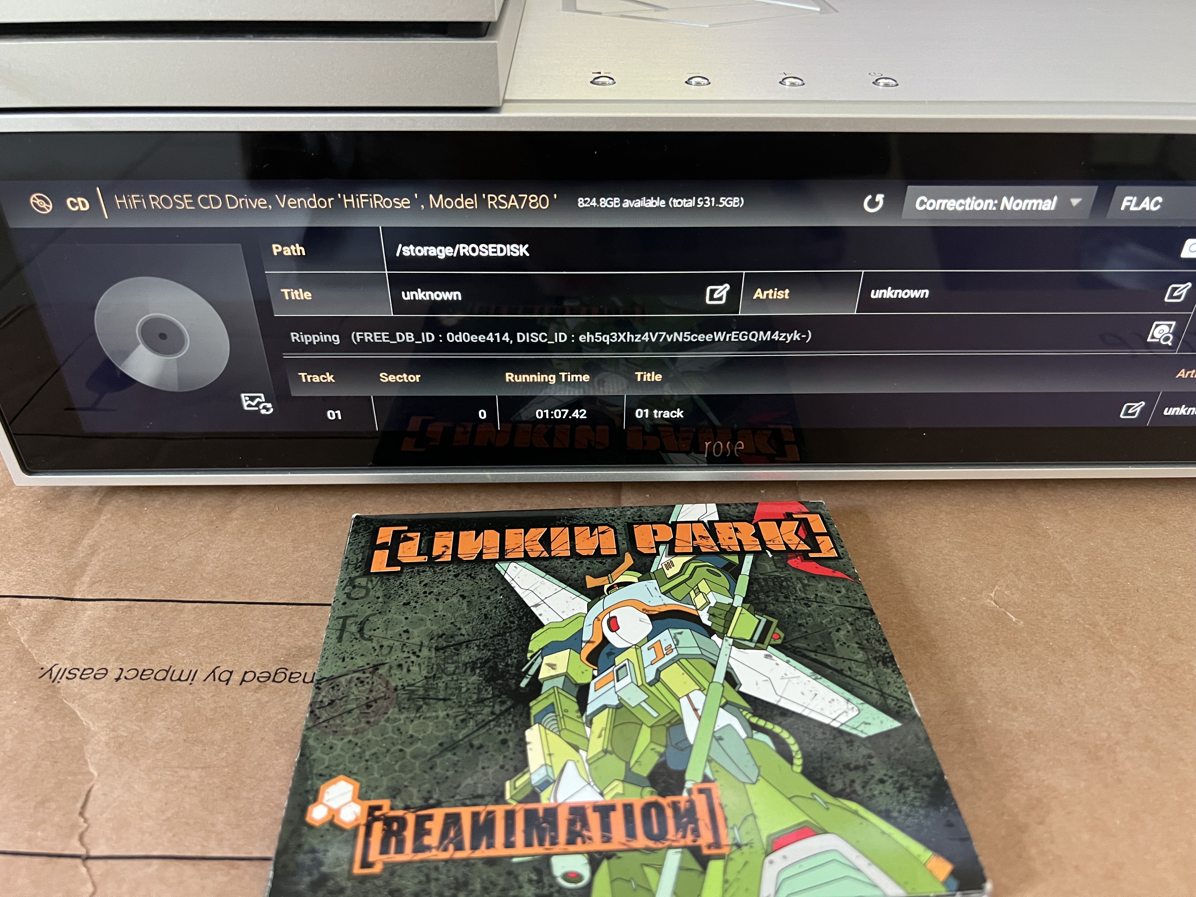

AND a stack of about 40 CDs were ‘unknown’ is returned eg Linken Park Meterora 93624 84432

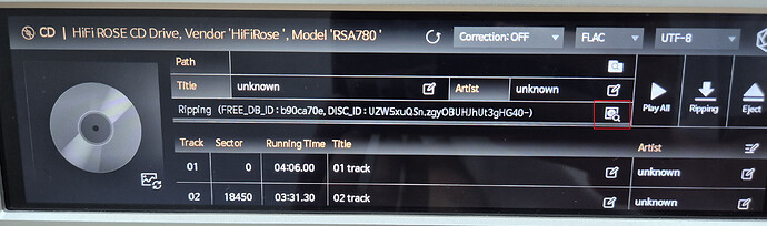

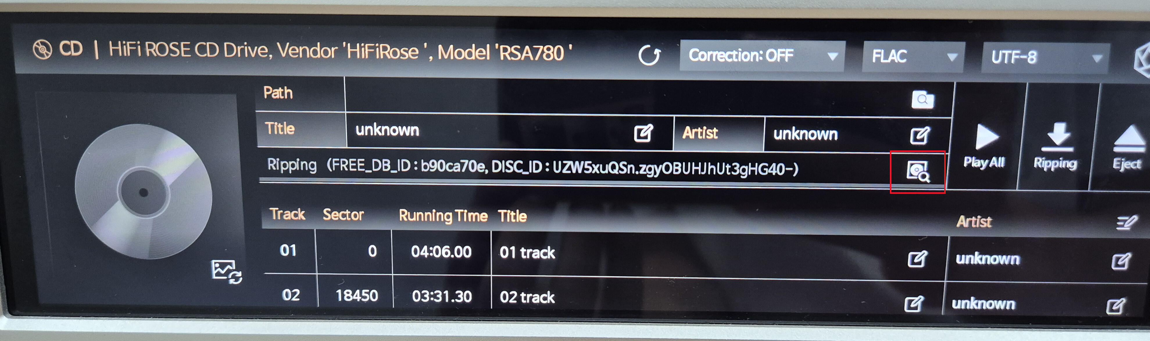

With this update, an Extended Search feature has been added for CD ripping on ROSE devices.
The Extended Search uses a more advanced search method. It first searches using the MusicBrainz Disc ID and the FreeDB API, and if no match is found, it performs an additional fuzzy search.
Before starting the CD ripping process, please refer to the image below (marked in red) and select the album that matches your CD.
If the CD metadata still cannot be found after using the Extended Search, please send us the Disc ID of the CD.
We need the Disc ID displayed on your ROSE device in order to search for and identify the CD in our system.

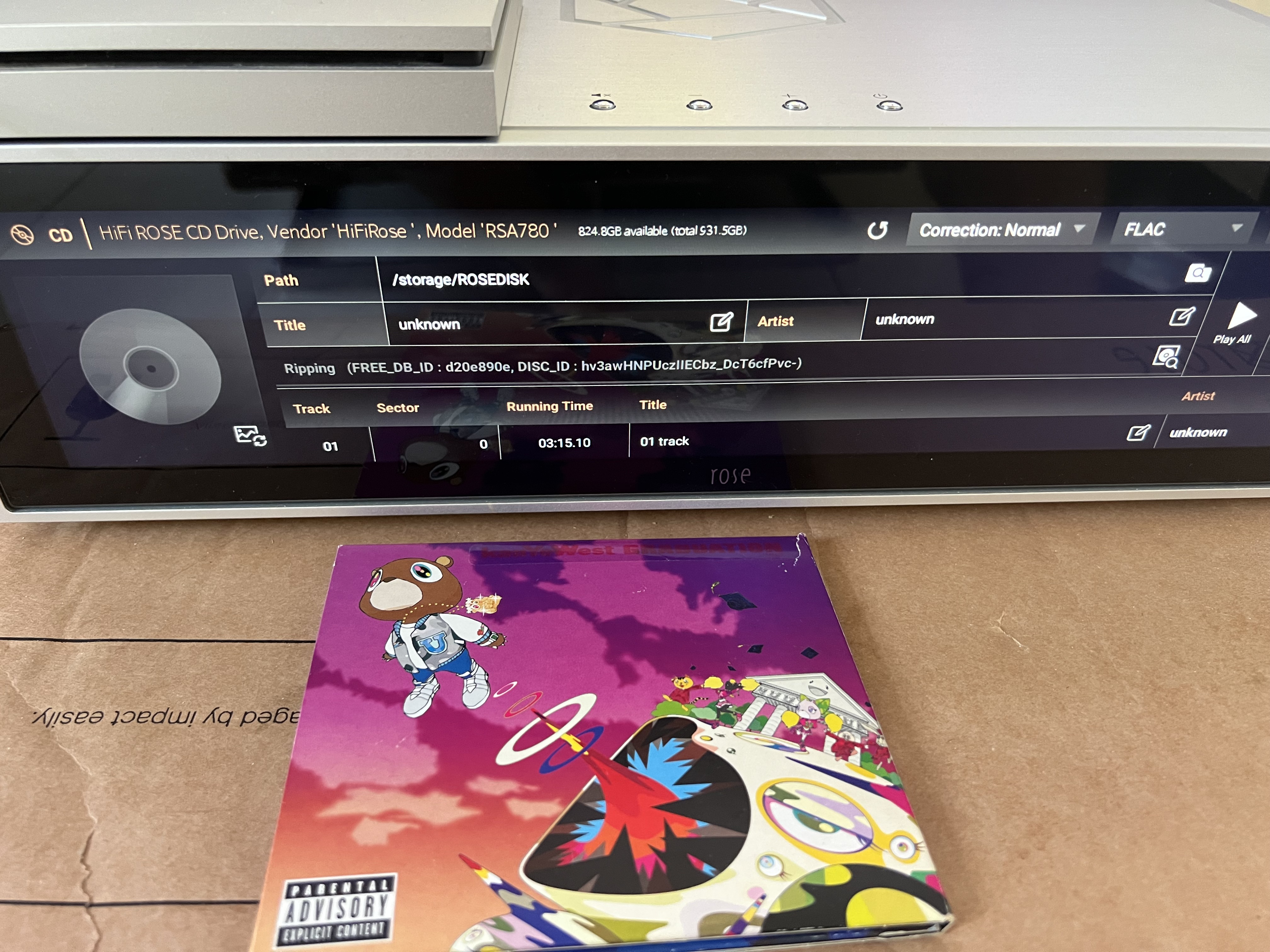

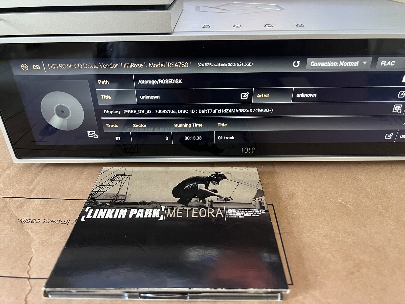

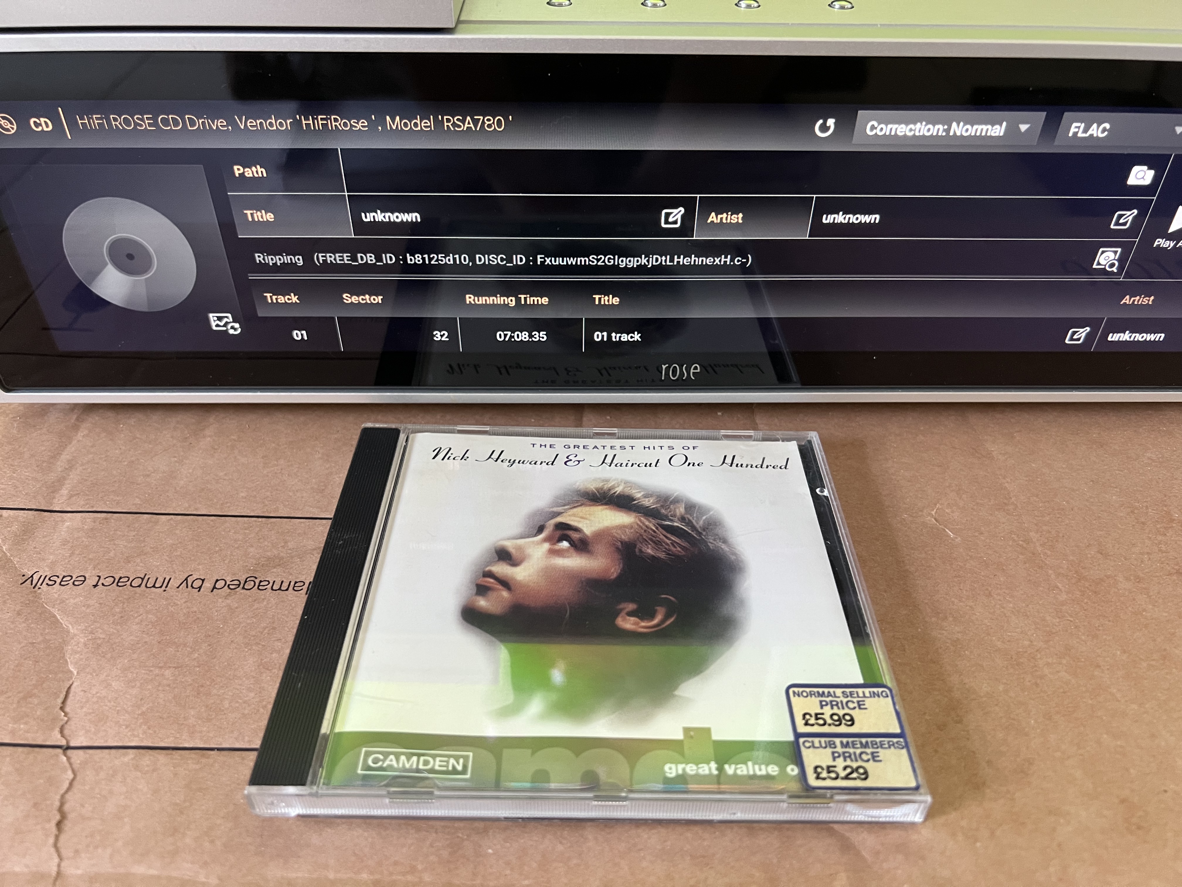

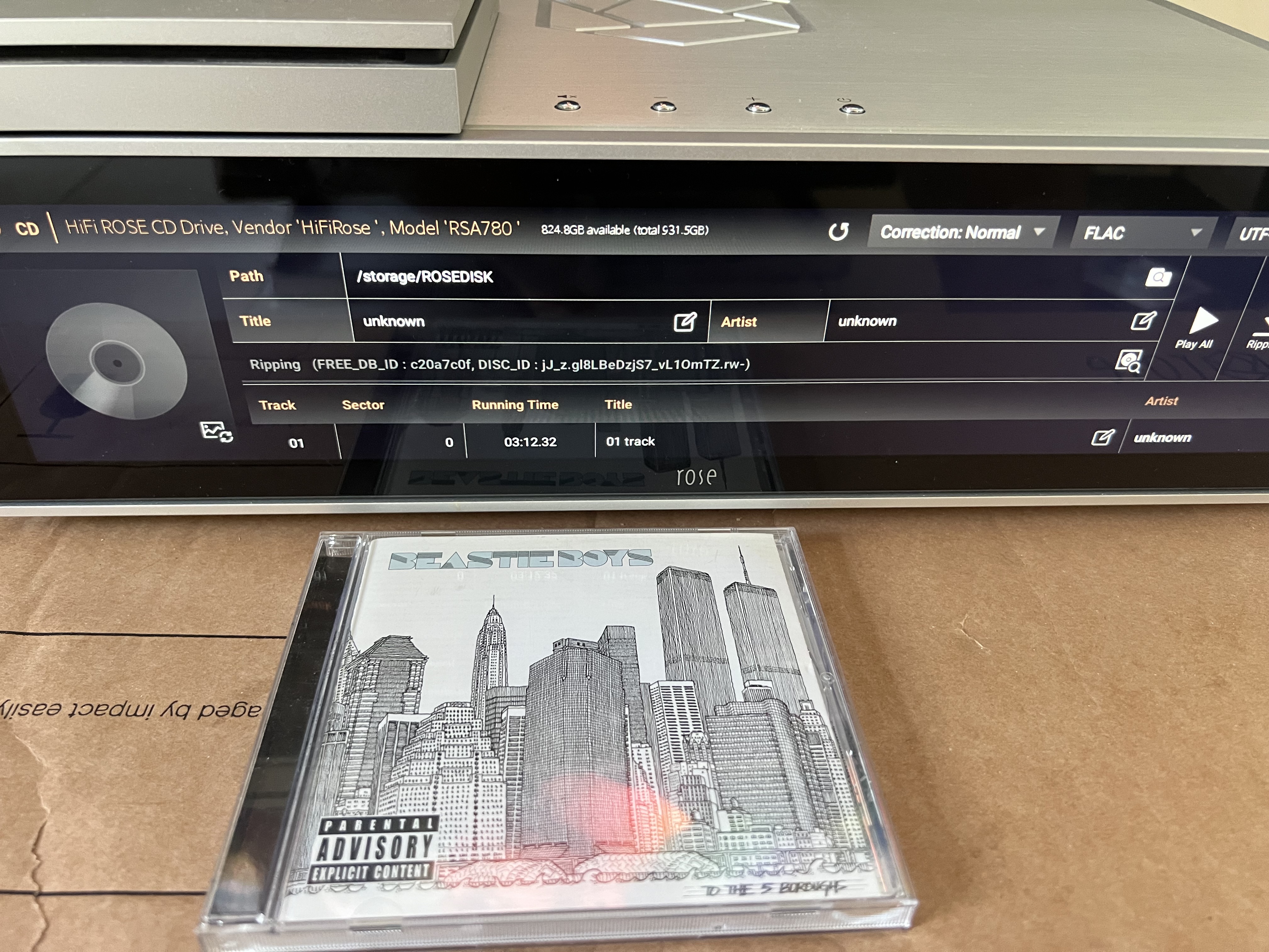

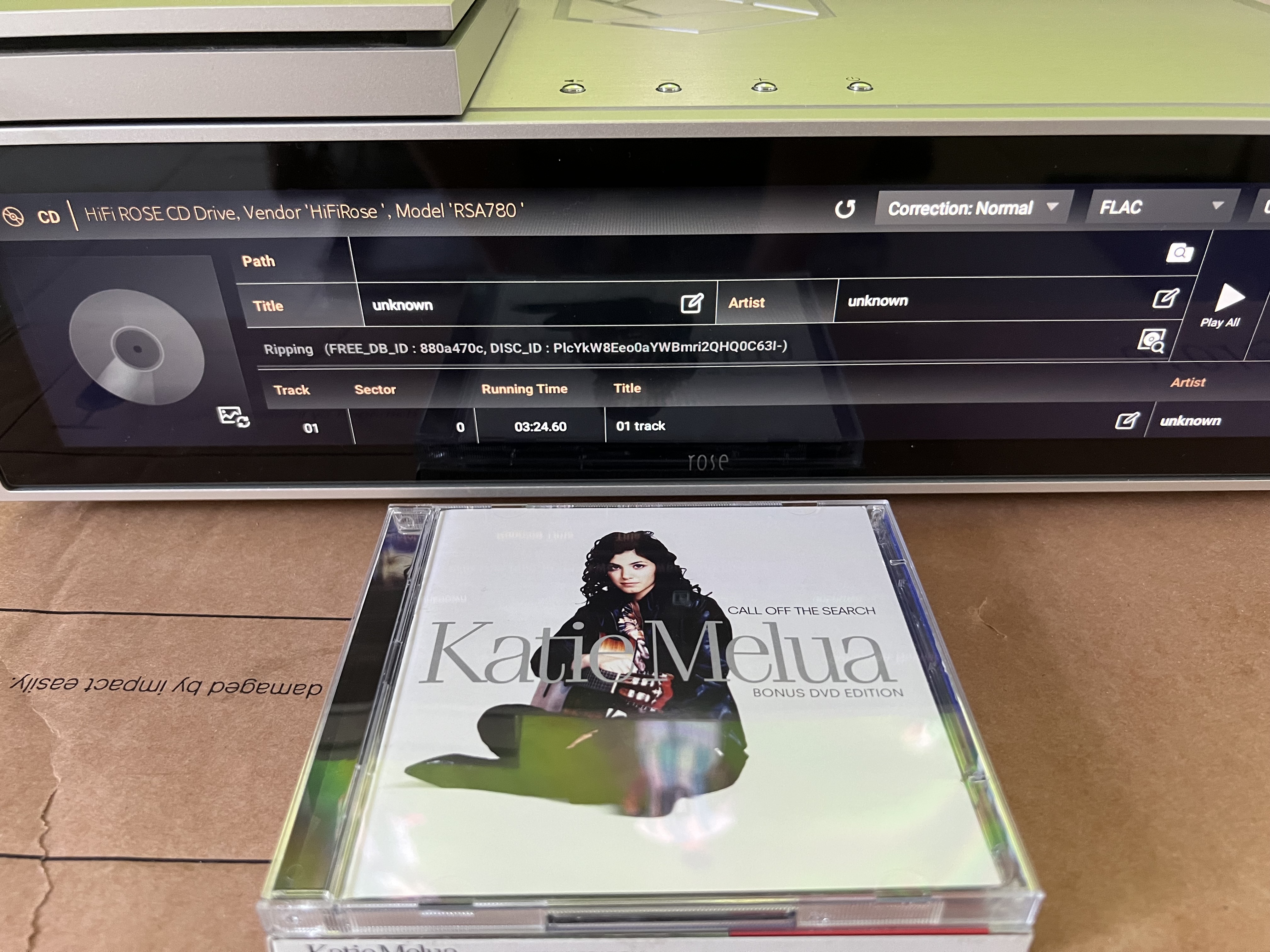

@ROSEHAN @Rose_love please see attached photos of ‘unknown’ CDs. Thanks
@DEFSKI66

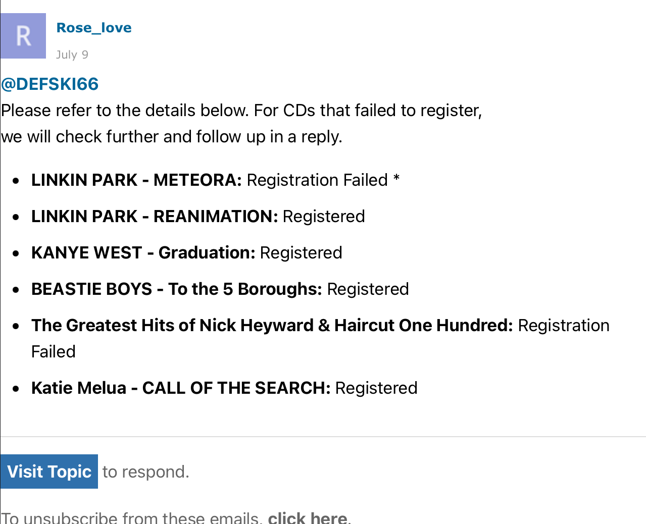

We have registered all the CDs you provided. Please check and confirm if they are working properly
This is the definition of insanity, using Rose to rip CDs. There should be a whole other part of this site for people who use Rose software to rip CDs and the metadata is not there. C’mon people, use your brains.

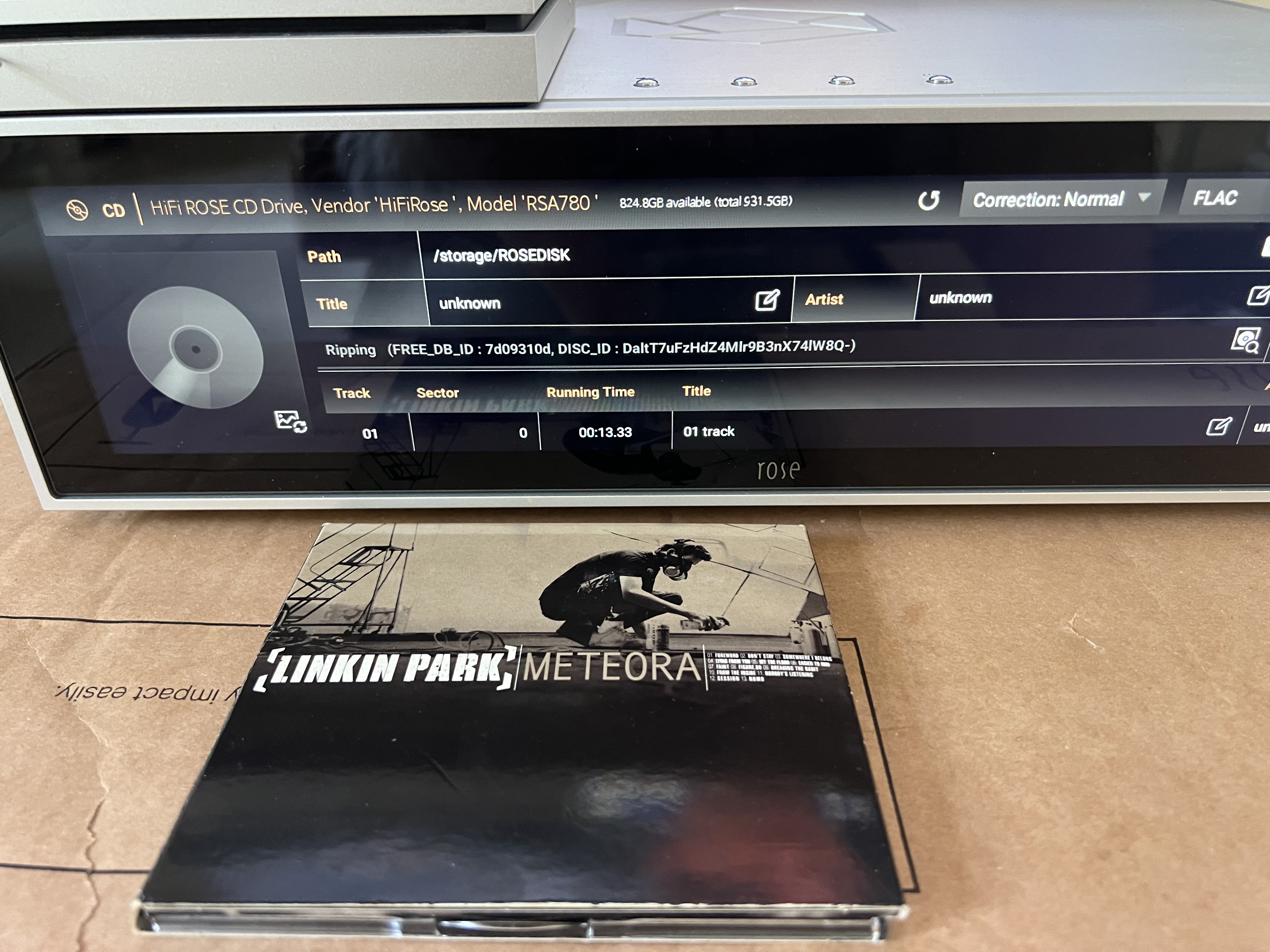

LINKIN PARK - METEORA is still coming up ‘unknown’
ALL the others successfully ripped!
Thank you for all your continued help and support.
@DEFSKI66

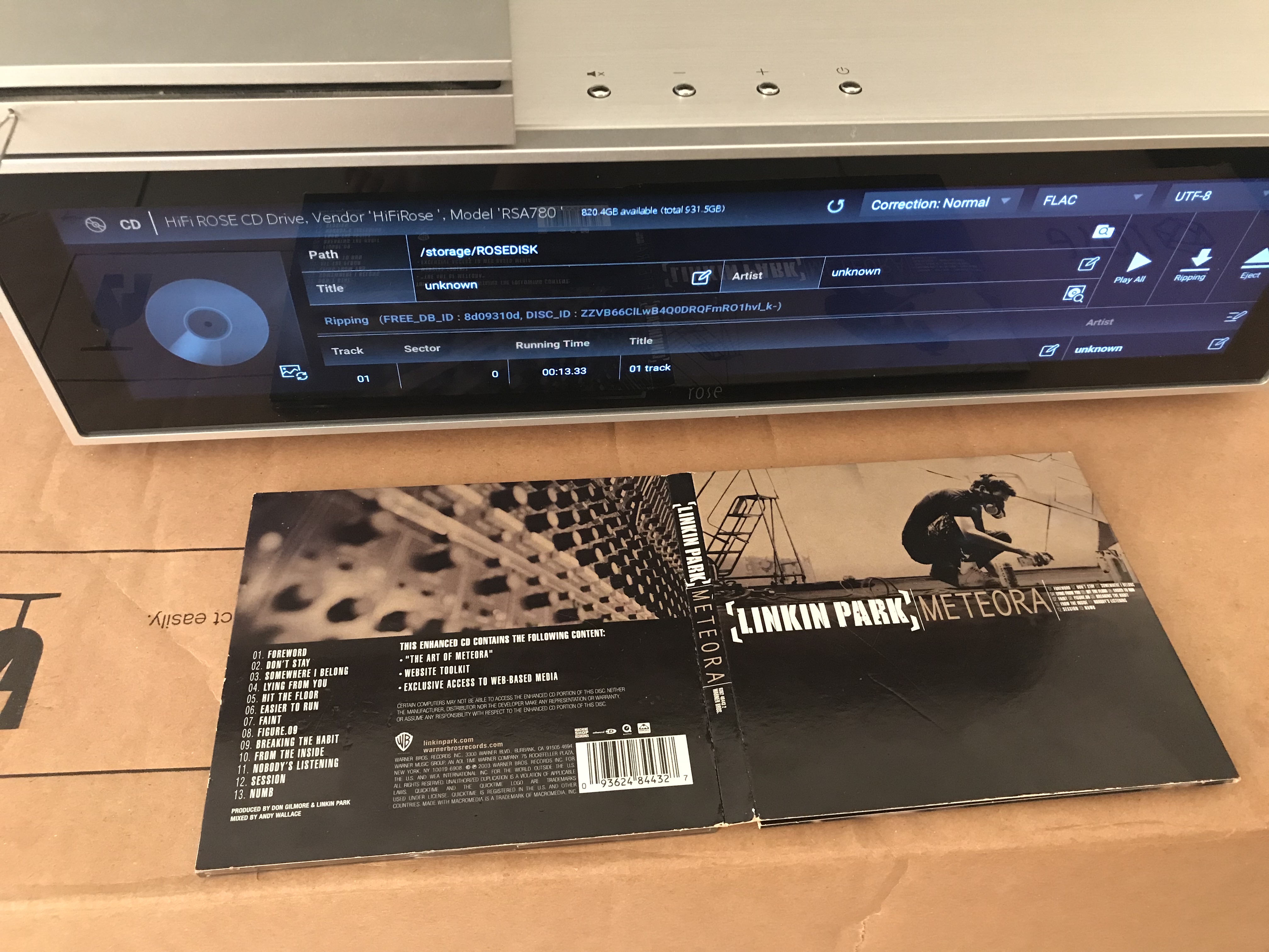

Is the “LINKIN PARK - METEORA” album still showing up as “unknown” across all menus, same as before? Could you please re-share the screenshot of the Rose issue screen along with the photos of the CD jacket?
@DEFSKI66
We have also registered that CD. Please check and confirm.
