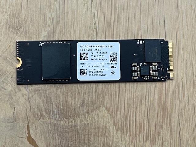

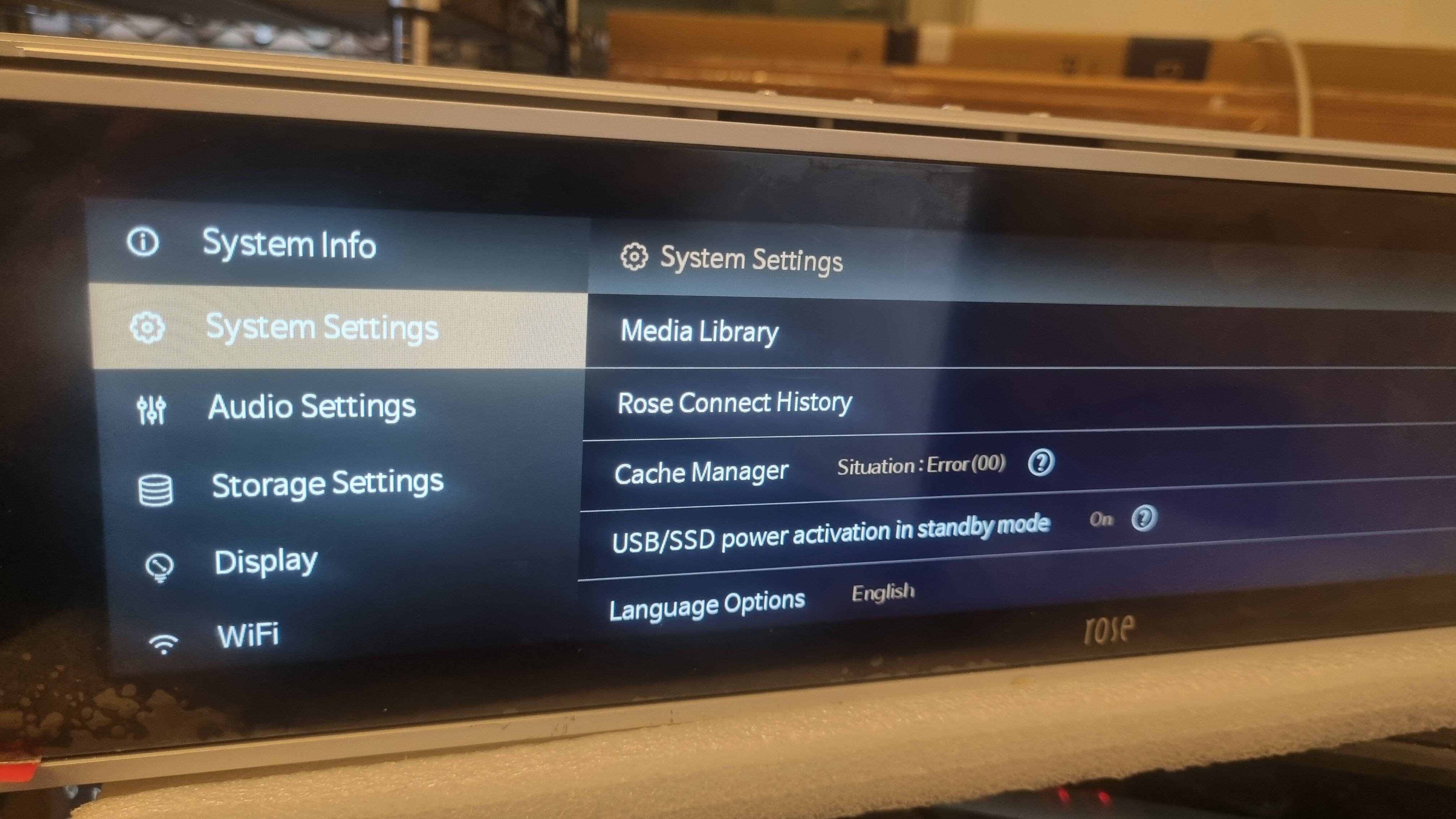

I’ve gotten into the habit of clearing the cache once a week. I’ve noticed that doing so keeps the sound quality consistent. I mention this because it seems to me that the SQ’s quality tends to degrade with use of the RS130; in fact, I even perform factory resets regularly. Last week, I got error messages 01 and 00 in the cache section when I tried to clear it.
@ROSEHAN @Rose_love
Do you have a solution to enable the new NVMe SSD cache?

I apologize for the delayed response.
The “00 Error” shown in the photo occurs when the NVMe is not properly connected, as illustrated in the image below. For testing purposes, if you remove the NVMe and clear the cache, the 00 Error will be triggered.
It is possible that the device is failing to recognize the drive due to damage to the connector or another underlying issue.
Greetings! But if everything is absolutely ok from the physical connection point of view, would the RS130 automatically format this M2 caching SSD, or should it be formatted using a PC before connecting it to the rose? What format should be used for M2 caching SSD (FAT, NTSC, etc.)? Thanks.

A quick update regarding the NVMe SSD cache issue: the WD SN740 SSD was indeed defective. The one I used as a replacement was a Patriot P400 Lite, which had the advantage of using half the power, but apparently it’s not compatible with the RS130. So I bought another SSD, a Kingston 500GB Gen 4, and everything is working perfectly again.
For your information, you shouldn’t format it or create a partition.
