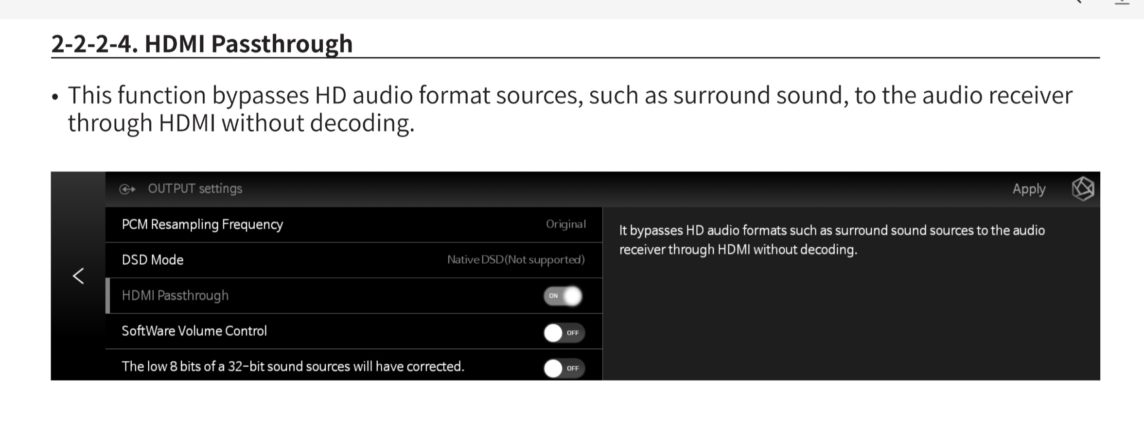

Where can we find the adjustment of HDMI Passthrough indicated in the documentation of the RS130 and not present in the menus of my RS130 or via RoseConnect?

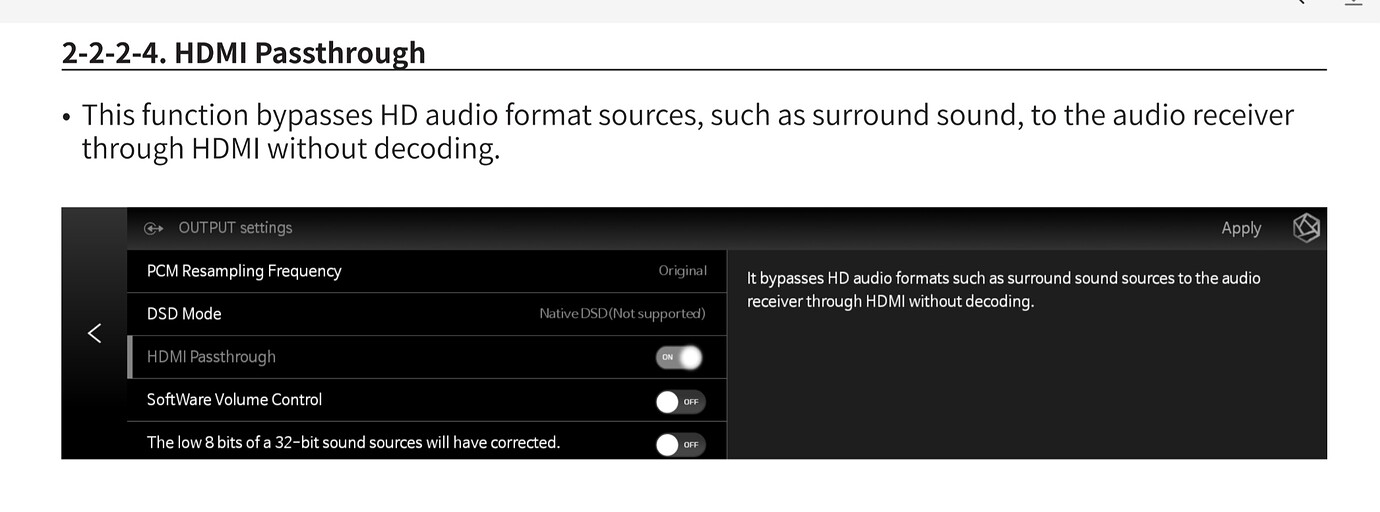

Where can we find the adjustment of HDMI Passthrough indicated in the documentation of the RS130 and not present in the menus of my RS130 or via RoseConnect ?
Documentation :
Versions :
@domrol
It bypasses HD audio formats such as surround sound sources to audio receiver through HDMI without decoding.
If you go into the input/output settings on the RS130, you can see that there is HDMI in the output. If you click on the small gear icon on HDMI, you can see that there is an HDMI Passthrough function.

@ROSEHAN The RS130 Documentation & HDMI Setting states:
17375794108384759582178381540041
Hence, according to the documentation & HDMI Setting, surround sound (and hopefully 3D sound like Dolby Atmos, DTS:X,…) are passthrough (ie, bitstreamed) on the HDMI port.
Please please request HiFi Rose’s development team to fix this bug (ie, to bitstream multi-channel music on HDMI).
