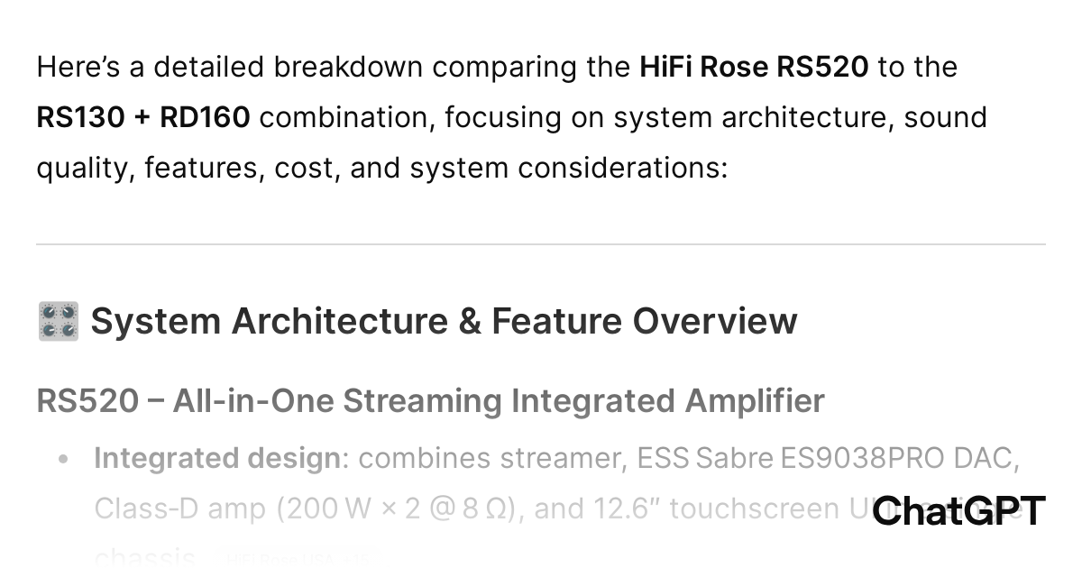

ChatGPT made a an accurate, but brief comparison…
