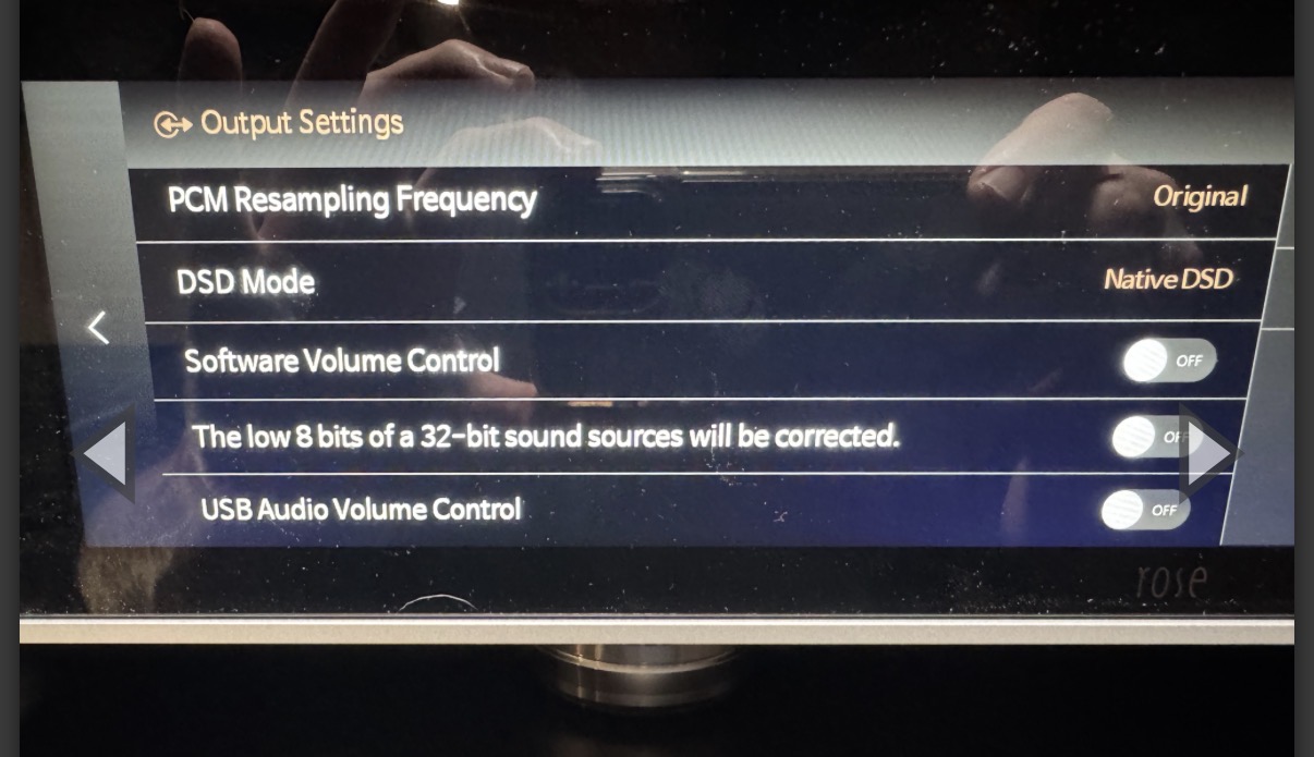

My RS130 does not play audio from Roon since this update. Its seen by Roon and it displays album art but does not play audio. I have restarted the unit, tried early access version, went back to official release but no luck.
Any help appreciated.
@fittebd had a solution for this problem.
“In the audio in and output menu click the little gear in the usb section. It takes you to the menu below. I clicked both the software vol control on and the usb audio vol control on. Saved. Then turned both off and saved. Then rebooted the unit. When it came back on and roon attached it was fixed. Roon was muting it when it really should not. It thought vol control was there. This bumped it.”IMG_7620

@MRD
I have sent an update notification to your email. Please kindly check your inbox.
I have received the fix and can confirm that issue with Roon has been fixed. Prompt reply and fix. All praise to @Rose_love

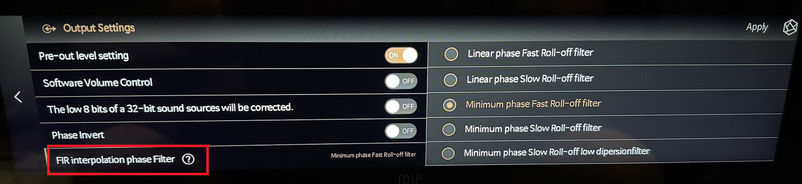

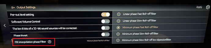

@ThierryMC
After the recent update, the only change related to sound quality is the filter name. There have been no modifications to the actual sound quality.
As you can see in the picture below, the filter names used in the previous version have simply been changed to the new names shown on the right after the update.
After updating, your Rose device may have automatically switched to “Minimum Phase Fast Roll-off (Default)”. We recommend checking your filter settings and re-selecting the filter that matches the one you were using in the previous version.
The default Minimum Phase Fast Rolloff provides a balanced sound, so we recommend using it for initial use.
It’s best to adjust the filter settings to your personal preference.
