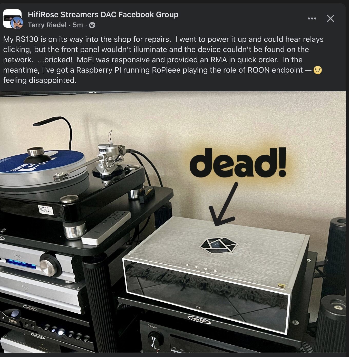

@Pascaal Starting to spread outside of this forum.
Hello fellow RS 130 owners. I thought I’d add a data point to this discussion. Like others are reporting here, my experience after the latest update has yielded a similar result: I hear relays switching, but the display does not light up and the Rose app doesn’t not see my RS 130 on the network. I have an email out to MoFi for next steps which I assume will be an RMA and a long wait time for repair. My RS 150B worked very well and I gave it to my son so he could enjoy it. Lesson for me is to not have auto updates selected. Hope it turns out well but disappointed nonetheless.
