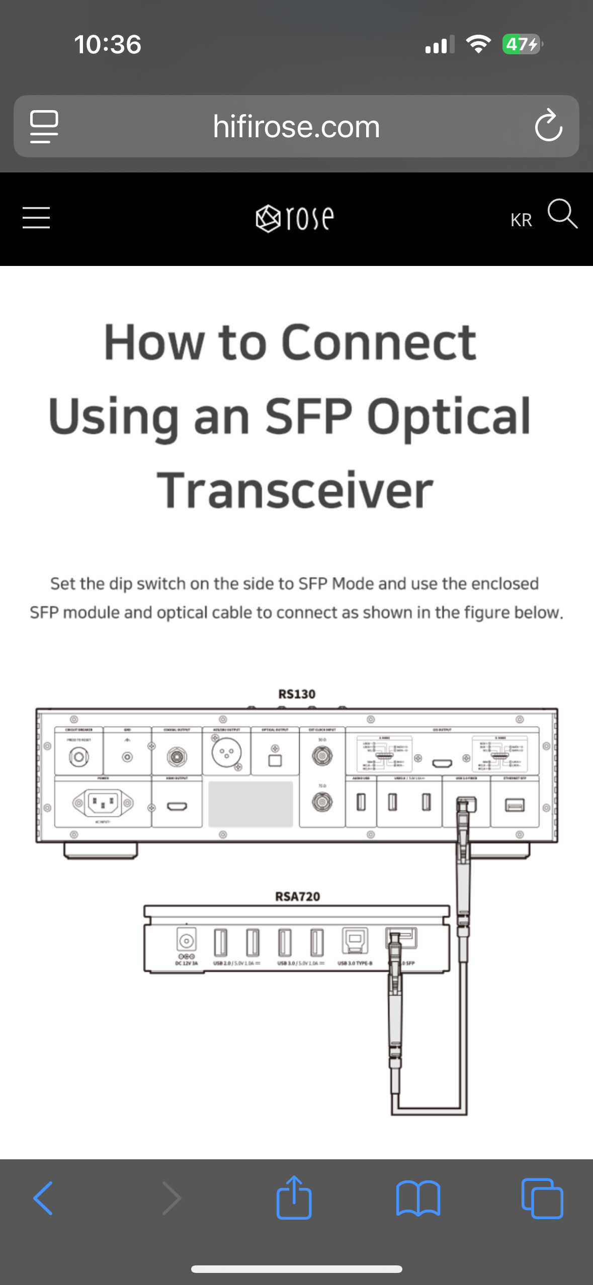

Quick question…, can all 3 devices RD160/RS130/RSA720 connect together by SFP?
@tommyleung
No, the RD160, RS130, and RSA720 cannot all be connected together via SFP.
Here is how SFP works in the HiFi Rose lineup:
SFP is designed for a point-to-point connection, primarily between:
RS130 (network transport) ↔ RD160 (DAC)
The RSA720 does not support SFP input/output, so it cannot participate in an SFP chain.
Thanks for the reply but there’s a diagram shows how to connect RSA720 with RS130 via SFP connector as per user manual
@tommyleung
If you have any other questions or encounter additional issues in the future, please feel free to let us know.
Hello, sorry for delay but the issue wasn’t solved although I showed you the diagram to connect the CD player to the rs130 but what about the connection between rs130 to rd160 using SFP since there is only 1 SFP outlet on rs130? That means the SFP connection can be done either rs130 to rd160 or rs130 to rsa720 not all 3 together by SFP cable?
@tommyleung
Hello, thank you for your inquiry.
The RS130 is equipped with only one SFP port, so as you mentioned, an SFP connection can be made with only one device at a time.
That means:
  • RS130 to RD160 via SFP, or
  • RS130 to RSA720 via SFP
You must choose one of these connections, and it is not possible to connect all three devices (RS130, RD160, and RSA720) simultaneously using SFP cables.
If you need to connect additional devices, please use other available interfaces such as USB, coaxial, or optical connections for the remaining components.
If you would like further assistance with system configuration or recommended setups, please feel free to share your full system details and we will be happy to help.
