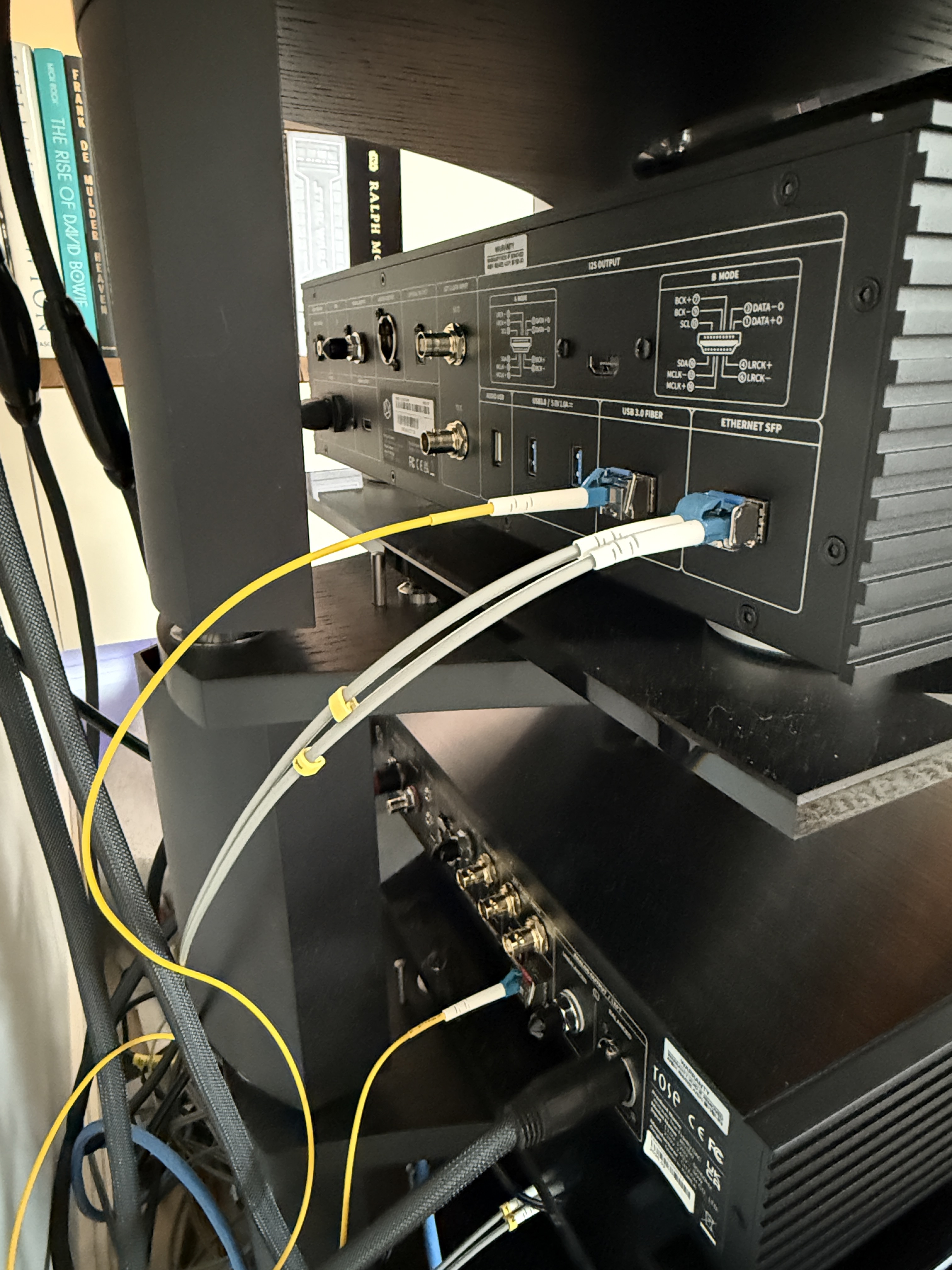

One of the SFP modules has a red tag on it, and the other has a blue tag on it - indicating a difference - but nothing in the manual about that. Anybody have any insight? …could be purely cosmetic - but would be a strange thing to do.
Here’s a pic:

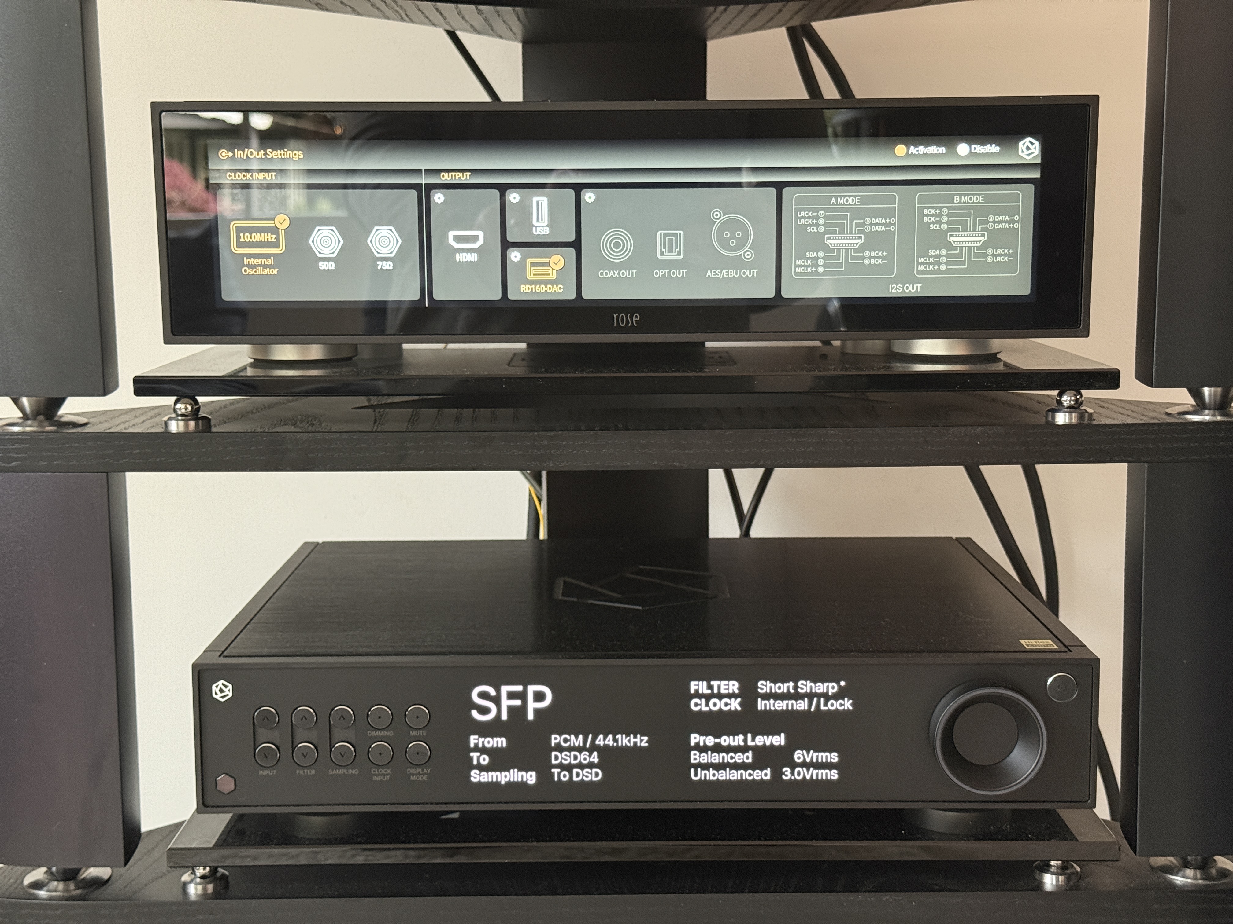

Here is a pic of my connectivity…
Hi Matt
I see from your pics you are listening to DSD64, are you aware that if you set the re sample rate on the 130 to 384KHz you will be able to listen to DSD512 through the 160 .
Also the 130 looks like it is not set to USB fibre 3.0 output for the 160.

On this - I’ll look into it - I’d kind of expected that the routine the two boxes went through to handshake when I set this cable up would have optimised things?
(And thanks - this is exactly why I posted this pic!)
Glad to help, happy listening :+1:

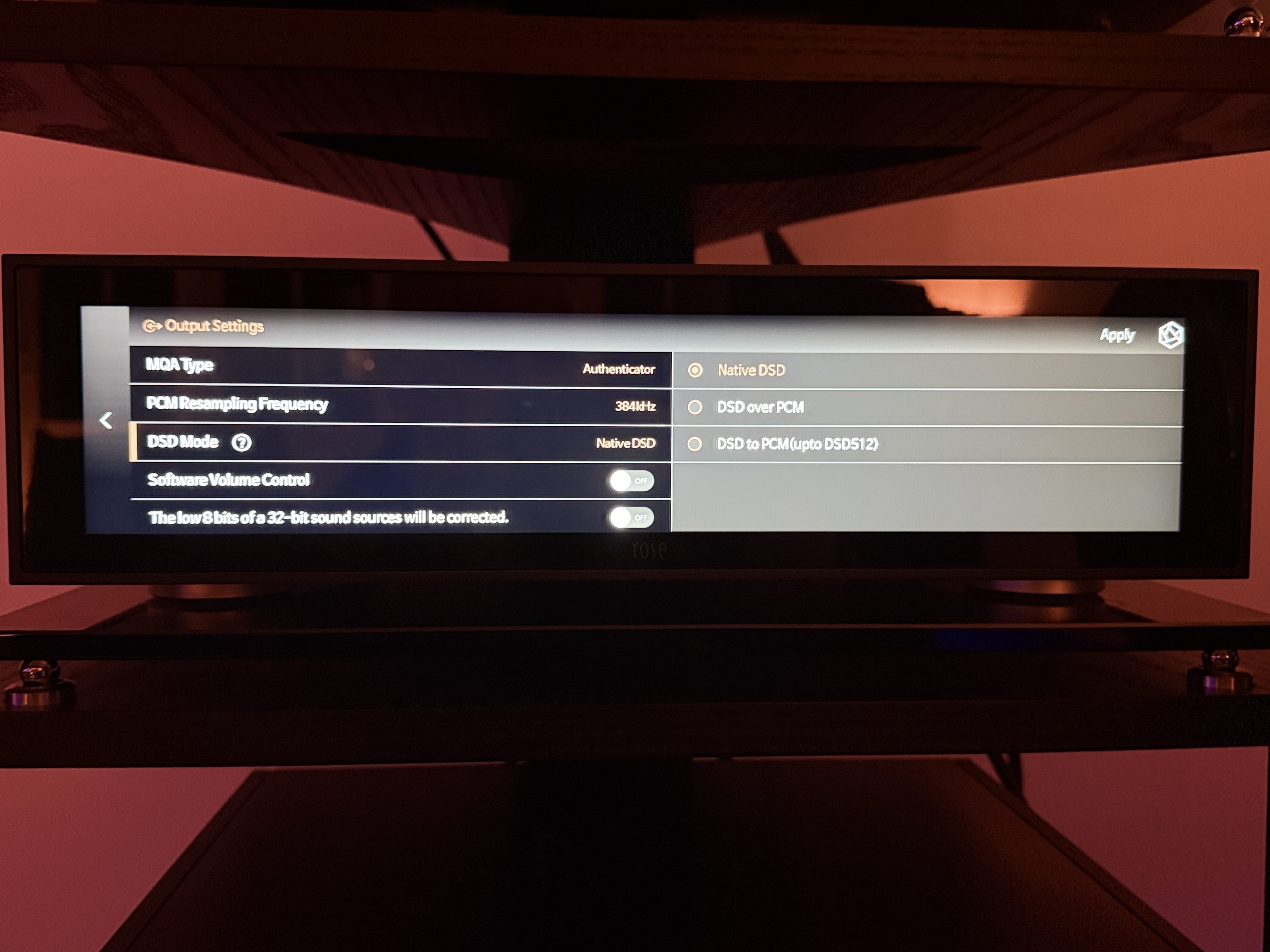

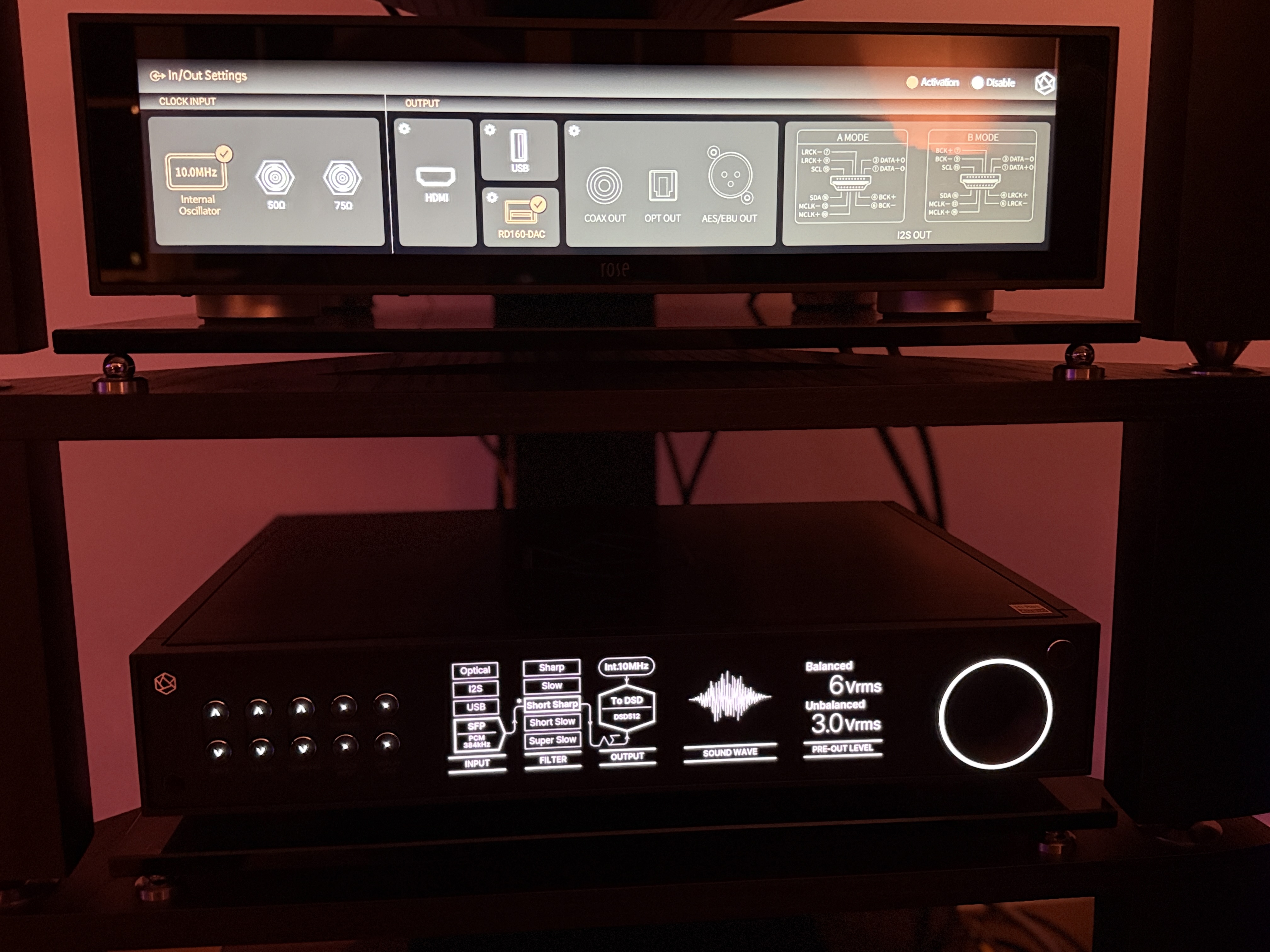

So I think I’ve done the Sample Rate - if you could share your experience to verify I’ve got this optimised now - thankyou!

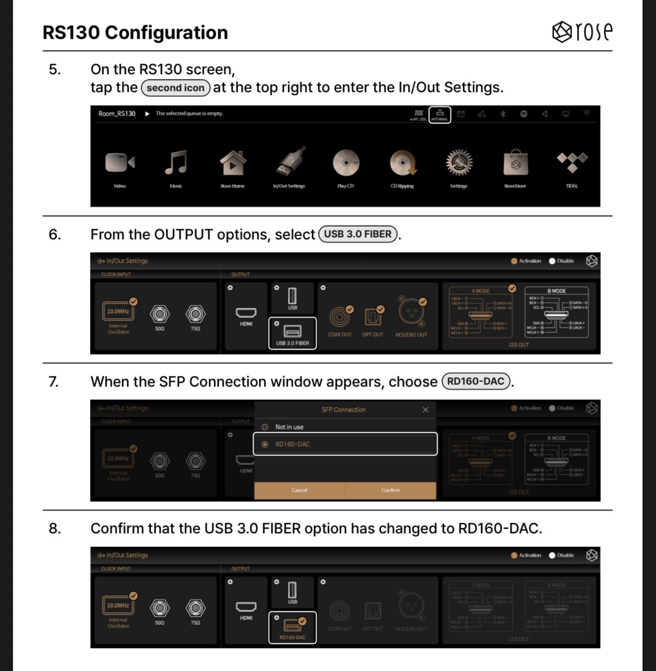

On the USB over fibre setting - I’m less clear - still looking - but I THINK I have it right as the manual says USB 3.0 Fibre changes to DAC RD160 when the connection is made - but any help as to how to optimise this if I’ve not is appreciated!
(I selected native DSD as I guessed that was better than the 130 converting to PCM only for the 160 to flip it back to upsampled DSD - I may be wrong though!)
All looks good to me.
Just for reference the native DSD setting is for playing/exporting original DSD files stored on local drives or NAS that are played from the original file. Therefore the native DSD setting will not affect the pcm output to the 160. The 160 converts the pcm to DSD.
