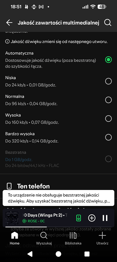

The Spotify update is rolled out here. Its available on my devices, but Rose needs a firmware update to activate it for spotify connect. And its the firmware update I’m worried about. If Rose dont do anything then it remains useless

I am writing to report a query regarding the Spotify Lossless (HiFi) feature when using Spotify Connect with my HiFi Rose RS130 streamer.
I recently gained access to the Spotify Lossless feature on my account, and it works correctly when playing directly on my iOS device. However, when I initiate playback using Spotify Connect to my RS130 unit, the Lossless indicator on my iOS device disappears, although the audio continues to play normally through the RS130.
I would like to confirm if the RS130 is still receiving and playing the Lossless audio stream via Spotify Connect, despite the indicator disappearing from the controlling iOS device.

Spotify has announced that lossless audio playback will be rolled out gradually depending on the region.
At this time, it is not supported on Rose devices.
If it becomes available in the future, we will make a separate announcement.
According to the latest information, Lossless will be gradually launched in more than 50 markets by October. Premium subscribers in countries such as Australia, Austria, Czech Republic, Denmark, Germany, Japan, New Zealand, the Netherlands, Portugal, Sweden, the United States, and the United Kingdom have already started using it.
It appears that SDK updates are required for support, but as of now, this does not apply to HiFi Rose devices.

Mr Rosehan I can confirm that I have lossless spotify now, but Rose resposne is very unenthusiastic and does not give confidence that they have any plans to support it soon,

I believe the issue could be the Android version and not having an SDK ready for it. That would explain the delay.

Spotify Lossless is working on my RS130. I’m running version 5.9.02
