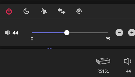

Only way to start / wake up is to use power button in Roon PC software.

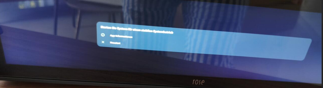

Then RS151 startup and shows following strange screen:
(app information + Neustart) => Pressing “Neustart” (Restart) than start device.

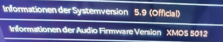

Firmware screen:
Pulling power plug for 5 min + cold start don’t change anything.
Please advice how to downgrad Firmware.

  2. Does your Rose device continuously display a reboot message when you turn it on?
    Does the same issue occur even after you factory reset your Rose device?
    Rose device–>Settings–>System settings–>Factory reset

  2. I have only seen the reboot screen two times. I did not enough test to get it reproducible. It also occurred after factory reset.
